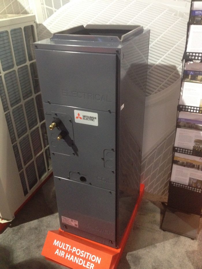

Looking at the products on display, I ran across several worthy of mention. Mitsubishi has just come out with a traditional air handler that works with the variable refrigerant flow (VRF) technology that the company uses in its minisplits. This heat pump now allows for this technology to be ducted throughout a house with products from a single vendor.

Mitsubishi air handler
Carl,
The Mitsubishi air handler IS a cool development...I just wish it were compatible with the M-series single-split outdoor units.
late to the game
Wow, Mitsu took that long to come up with that type of air handler??
I thought its market arrival was "imminent" back when my Daikin ducted
system went in, early 2012.
Since the Daikin unit was part of the "Skyair" family more geared toward
light commercial installation than residential, it doesn't surprise me
that Mitsu offers this with the "city multi" line, which I guess is their
rough equivalent but less compatible with the small outdoor units.
_H*
Mitsubishi Air Handler
John - I didn't get into any in depth discussions with the rep at the conference, but he did tell me that it must be connected to an outdoor unit with at least one other inside fan coil - either another air handler or a ductless head. My biggest frustration with the mini splits is that they multi head units are so much less efficient than the one to one systems. Their wall mounted now has a SEER rating of 30, which drops quickly once you go to the multi head system. I don't know the physics well enough (or at all) to know why, but it seems like they could improve on this.
