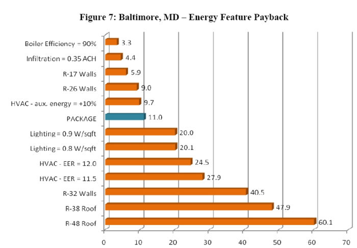

HERNDON, VA — A report published by a real-estate development group concludes that there is no cost-effective way to build a new commercial office building designed to use 30% less energy than a code-minimum building.
According to the New York Times, “The report, released this week by the Commercial Real Estate Development Association, found that a 50 percent energy improvement beyond federal standards is technically impossible. A 30 percent target is achievable, but only by adding a million-dollar solar system that could take up to 100 years to pay for itself.”
The real estate development association — sometimes known as NAIOP, the acronym of its former name — hired energy consultants from Consol in Stockton, California, to run computer simulations on an imaginary four-story office building built to ASHRAE Standard 90.1-2004 in three cities: Chicago, Baltimore, and Newport Beach, Calif. The researchers examined the effects of a variety of energy upgrades, including air-sealing measures, improved insulation, improved glazing, reduced lighting levels, efficient HVAC equipment, and photovoltaic arrays.
Consol researchers hoped that a combination of cost-effective measures might reduce energy use to 30% below that of the baseline building. Measures were considered cost-effective if the payback period was 10 years or less.
Maximum Achievable Energy Savings: 23%
The report, “Achieving 30% and 50% over ASHRAE 90.1-2004 in a Low-Rise Office Building,” concluded, “The analysis was not successful in identifying practical energy feature upgrades to achieve the 30% threshold. The best scenario evaluated achieved 23% over the ASHRAE 90.1-2004 Standard. …With the Package features noted … the Chicago, Baltimore and Newport Beach models achieved 23.0%, 21.5% and 15.8%, respectively, over the ASHRAE 90.1-2004 Standard. These could represent the practical and economical limits of current construction within this office building model. Increased energy features from these levels would drive the Package payback period well beyond the ten-year time horizon. Additional energy savings are required to reach the 30% and 50% goals. Outside of increasing building energy features, one way to do this would be to generate electricity via photovoltaic panels. These systems would cover approximately 11,000 square feet and could be installed on the building rooftop. However, with an installed cost of over $1.1 million … and a payback period between 55 and 100 years, they would be economically impractical considering the industry accepted ten-year timeframe.”
