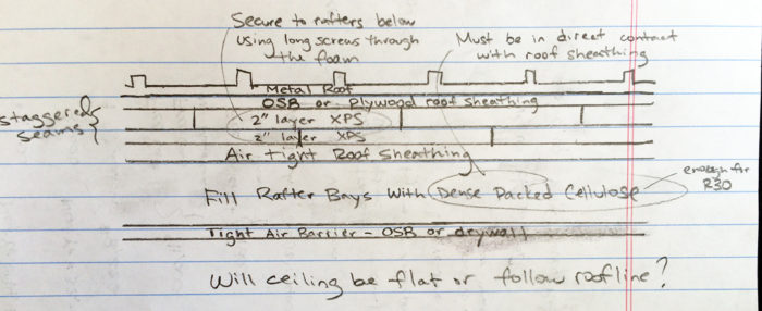

If only Kevin Hoene’s choices for a new roof boiled down to a choice between an EPDM membrane and metal, his life would probably seem a whole lot simpler.
But Hoene, building a new home in Illinois and on the boundary between Climate Zones 4 and 5, will soon be weighing the pros and cons not only of different roof coverings, but also of what type of insulation to use, whether it should go above or below the roof sheathing, and whether the roof should be vented or unvented. In other words, nothing seems off the table.
“Our house is being built near the boundary of Zone 4 and 5 in Illinois with a 1:12 pitch metal roof,” Hoene writes in a Q&A post at GreenBuildingAdvisor. “I’ve done a lot of research on low-slope roofs because our builder does not have a lot of experience with flat roofs.”
After reading a couple of articles on the topic by GBA Senior Editor Martin Holladay, Hoene is leaning toward an unvented roof assembly (see the sketch above), which would include cellulose insulation in the rafter bays and 4 inches of extruded polystyrene (XPS) rigid insulation above a layer of airtight sheathing. That would be followed by a second layer of OSB or plywood sheathing and, finally, the metal roofing.
“Does the diagram look like a good approach?” he asks. “Any details that I should pass along to our builder about the roof trusses?”
Those questions are the start of this Q&A Spotlight.

As the homeowner of the project in question, I'd like to follow up about how we ultimately proceeded. After much discussion, we chose to do an unvented assembly. Our roofer used 90 mil EPDM on top of 1/2" densdeck on top of 2" polyiso on top of 7.5" EPS on top of asphalt felt.
With the insulation at the roofline (and the vertical walls insulated all the way to the roofline), the attic is completely inside the conditioned space.Your article cites the need for venting with inside air. This takes me back to the use of recessed can lights. Since the barrier is now at the roofline and not at the ceiling, is there no longer a need for an airtight ceiling? is it acceptable to use can lights now? Will can lights actually be beneficial because they will help ventilate the attic space with inside air?

Q. "Your article cites the need for venting with inside air. This takes me back to the use of recessed can lights. Since the barrier is now at the roofline and not at the ceiling, is there no longer a need for an airtight ceiling?"
A. First of all, I am less convinced that Peter Yost or Brian Knowles that the type of attic you are describing -- an unvented conditioned attic that is entirely within the home's thermal envelope -- needs any kind of venting, especially when all of the insulation is on the exterior side of the roof sheathing. I'm not sure what purpose this venting with interior air is intended to serve. While it's true that some attics insulated with open-cell spray foam on the interior need to be deliberately conditioned with a home's HVAC system to lower the chance of moisture accumulation in the sheathing, your roof assembly has no open-cell spray foam.
So, here's my advice: don't worry about "venting" this unvented conditioned attic.
You can install all the can lights you want in your ceiling. Both sides of the ceiling are indoors, so you aren't penetrating an air barrier.

If the upper edge of a low-slope shed roof intersects a vertical wall, the most logical approach (in my opinion) is to detail the roof as an unvented roof.
Another approach is to build a cupola or ventilated doghouse in the middle of the low-slope roof -- an approach championed by Joe Lstiburek.
For more information on either of these approaches, see Insulating Low-Slope Residential Roofs.

I am working on 3 projects currently where we have a low sloping roof like the one discussed above that terminates against the gable end of the house; think typical Vermont vernacular. We are creating a well ventilated space above the well-insulated, low-slope roof and have vertical 3/4 strapping creating a drainage plane for the gable end wall. Keeping water, rain and snow out of the vent space prevents us from connecting the two air spaces and thus the low-slope roof needs its own vent at its higher termination against the wall. Are there systems/details/techniques others have used that work for this application? I've seen some ridge-vent like systems available, but wonder how they work under wet snow, etc. Here's a preliminary section detail...
