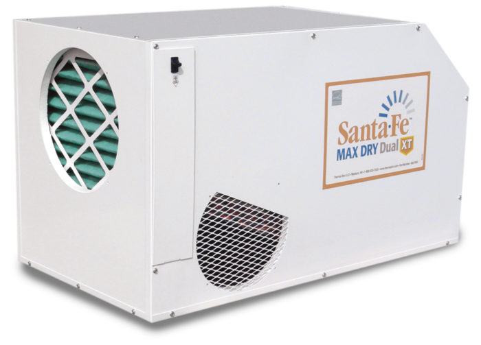

The most energy-efficient dehumidifiers today are made by Therma-Stor Products, of Madison, Wisconsin. The company offers a wide range of both free-standing and ducted dehumidifiers that are typically integrated into forced-air distributions systems. Standard stand-alone dehumidifiers typically cost $150 to $300, while top-efficiency models, such as most of those from Therma-Stor, will cost over $1,000.
