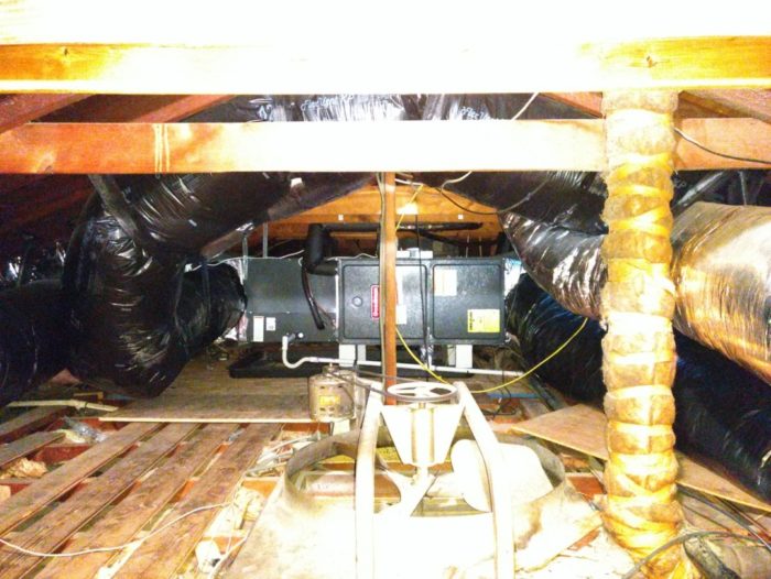

Ted has more than a few cobwebs in his attic. The unconditioned space also houses his HVAC system.
The 1,800-square-foot brick ranch in Climate Zone 4 dates from the 1960s, but the previous owner installed both a furnace and ductwork in the attic just four years ago. Ted also has inherited a powered attic ventilator. Although both the attic floor and the ductwork are insulated, Ted recognizes the situation isn’t ideal.
Summer hasn’t even arrived, he notes in a post at GBA’s Q&A forum, and when the temperature outside climbs to more than 95°F, the temperature in the attic tops 120°F. That has kept the ventilator working, but Ted surmises the high temperatures are reducing the efficiency of his air conditioning equipment.
“Should I turn off the ventilator so it won’t suck cool air from the conditioned area?” Ted asks. “Should I put more insulation material on top of the attic floor and the ductwork? Will a radiant barrier under the rafters help?”
Those are the questions to get this Q&A Spotlight rolling.
Add more insulation
Dana Dorsett would have Ted get the level of insulation much closer to the R-49 recommended in the International Residential Code.
“In a DOE Climate Zone 7 (not to be confused with a USDA plant hardiness zone 7) a mere 8 inches of fluff is woefully inadequate,” Dorsett says. “IRC code-minimum for zone 7 is R-49, and you have barely half that. Air sealing all the ducts and air handler connections and seams, and air sealing all the duct boots to the ceiling gypsum (and any other penetrations) is a critical first step prior to adding any insulation.”

In more cases than not a 3 ton AC with the ducts in the attic has a ton or so of load that's just from the location of the ducts in the attic and the associated duct gains, leakage, etc.. The remaining 2 tons of capacity is at least 1.5x oversized for the actual 1% load. So the real cooling load for the HOUSE is likely to be no more than 1-1.3 tons, but it could even be on the order of 3/4 tons with the air leaks to the attic & sagging attic insulation are corrected. Of course a Manual-J is better than a WAG, but the WAG probably isn't that far off.
Depending on the floor plan a single 1 ton or 1.25 ton cold climate mini-split may be able to cool the whole shebang more comfortably & cheaply than the noisy Medusa of moldy flex in the attic, and also heat most of the place 75% of the time at about half the cost of heating with propane (or less). If the mini-split keeps up with the cooling load sealing up the registers to the ice-maker in the attic (lowering both the heating & cooling load) would be easier to argue, without having to start the 5th grade science lesson all over again.

What happens if one simply places insulation between the roof rafters?
Response to Bruce Thompson
Bruce,
Assuming that there isn't any rigid foam above the roof sheathing -- and we know that Ted's roof doesn't have any exterior foam -- you can only install fiberglass batts between the rafters if you also create a ventilation channel between the top of the fiberglass batts and the underside of the roof sheathing.
Creating this type of ventilation channel will only work if (a) there are soffit vents at the base of each rafter bay, (b) there is a ridge vent at the top of each rafter bay, and (c) there are no dormers, skylights, valleys, or hips that interfere with the ventilation channels.
To learn more about all of the different ways to create an insulated sloped roof assembly, see this article: How to Build an Insulated Cathedral Ceiling.
Now, to your question:
Q. "What happens if one simply places insulation between the roof rafters?"
A. One sets up a risky situation that encourages moisture accumulation in the sheathing, mold, and possible sheathing rot. And one is guilty of a code violation.

Hi all, I hope you can help. 1965, two story house, located in DOE 3A (hot/humid), Dallas, TX. I've got a 21 seer machine cooling my upstairs (1000 sq ft) and some old Carrier cooling the downstairs (1000 sq ft). 3 years ago, I had new siding put on the top part of the house (bottom is brick). This required the vinyl siding to be removed, the layer of styrofoam insulation removed, the original wooden siding taken off and the tar paper the house was wrapped in removed. Then we put in new insulation (R15), covered the walls in plywood, applied vapor barrier and new LP siding.
Ever since then I have one vent that does nothing but condensate. It is coming right off of the AC plenum, so I was thinking it was the difference of the temps (keep it around 74 during the day, down to 64 at night). I'm running a dehumidifier 24 hrs upstairs.
The AC inside units are both located within the house, however the upstairs unit doesn't have a proper ceiling on it. There is a piece of wood on top, but I know it's not stopping any hot air as I can feel it when I open the closet it's in.
My attic is very hard to get around it - you can't stand up in it. The ducts for the upstairs unit are in this attic. There is no thermal foam/reflector barrier at all, although I do have 2 whirly birds and 2 new passive vents to help move the air out of the attic (the 2 passive vents have resulted in a dramatic cool down in the attic after the sunsets, which is nice - i know this based on my power consumption). When I bought the house there was about 1/2" of fluff up there (original construction?) and we added up to 12" additional fluff (there's not much room to add much more or the entire attic would be full LOL).
The attic ductwork is flex duct work. It was new when the AC was put in 7 years ago.
Recently I had another HVAC company come out and put in a new bathroom vent and they told me they believed the duct work was full of water. I called out the original HVAC company and they took a look and said they saw no water. Now, I know I should get up there myself, but I haven't.
The new HVAC company recommended that I get metal ducts put in instead of the flex ones. They believed that would stop the moisture.
After reading this thread, I'm honestly not sure what to do. The temps in Dallas can get over 105 in the summer, so I'm not sure if bringing the attic into the conditioned air is feasible. When I bought the house I was told the pitch of the roof is so steep they can't get in there to apply the spray foam insulation...has that changed do you think? Are there other duct types I should be looking to replace the flex ones with? Would that even change anything? Is it the fact that we sealed up the house much more than it had been before and now it can't properly breathe?
For what it's worth, I'm not having any issues with the unit downstairs, but those ducts are within the AC part of the house. Prior to this, the downstairs AC unit cooled the entire house (not too well). Upstairs never got below 75 at night and the ducts were those box metal ones from god knows when and never had moisture issues.
Any suggestions are appreciated. If it's something I need to save up for to do it right, I will.
If I understand correctly, you are getting condensation on AC ducts in unconditioned space. I'd push harder on getting someone to apply spray foam to the ducts.
You understand correctly! So the ducts are that flex duct...would that withstand the spray foam? And how much should they apply to get the R factor I need?

>"I do have 2 whirly birds and 2 new passive vents to help move the air out of the attic (the 2 passive vents have resulted in a dramatic cool down in the attic after the sunsets, which is nice - i know this based on my power consumption). "
Turbine vents usually depressurize the attic sufficiently to pull conditioned air up through the air=-leaky ceiling into the attic, which increases the cooling energy use. The passive vents probably reduced that negative effect by allowing more air to flow from the the outdoors, but it's still almost always better from an energy use point of view to NOT use turbine vents or powered attic vents of any significant size.
In your location it may be worth removing/sealing all roof/attic vents entirely, and air sealing all leak between the attic & outdoors for both energy use and moisture control reasons. In humid climates like the Gulf Coast (including up to Dallas) vented attics usually bring more moisture into the attic than they purge. Even if the insulation layer is at the attic floor you'll probably be better off making the roof the pressure boundary of the house, in which case the absolute moisture levels (but not the temperature) of the attic will track that of the conditioned space below, which should reduce the condensation potential dramatically.
Peak attic temperatures and most of the moisture can be reduced by installing perforated alumized fabric radiant barrier the underside of the rafters over the entire attic ceiling. The perforated fabric type is preferred, since that guarantees a drying path toward the interior, whereas the overpriced bubble pack or the unperforated aluminized fabric types are true vapor barriers, which could create moisture traps. At about 5 perms the perforated goods still limits the rate of moisture flow, so even if there is some minor air leakage at the soffits or imperfectly sealed vents the main volume of the attic won't be subjected to the high dew points of summertime air freely flowing through the attic, which is what you have right now. Air leakage from the outdoors is the primary enemy you're fighting here.
