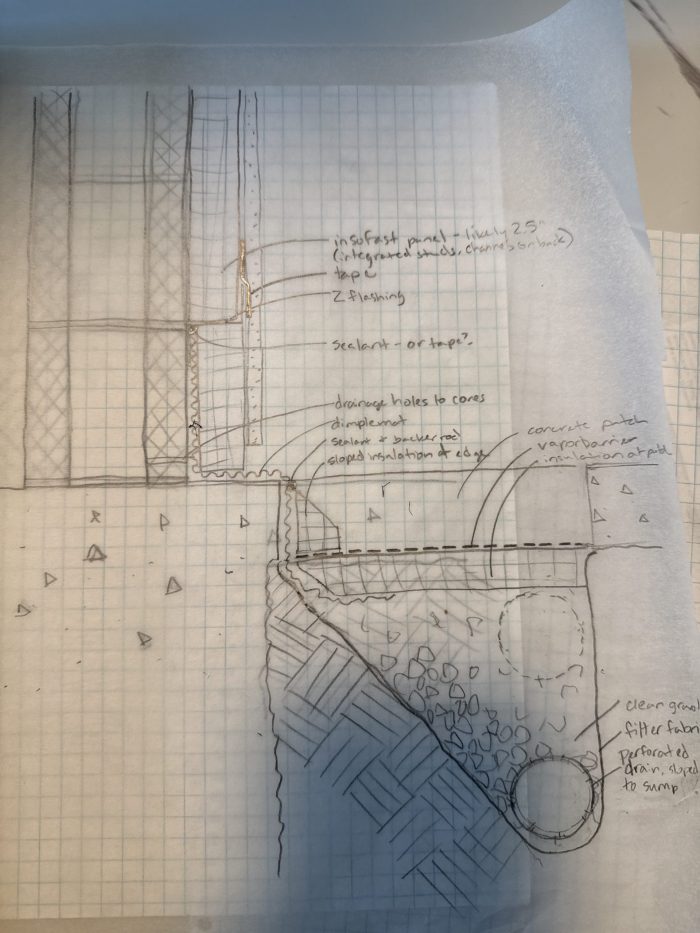

We have a 1900 farmhouse in northwest Massachusetts that has a stone foundation and an old concrete slab that most likely does not have poly under it. A lot of water comes through the walls and maybe up through the floor. We're working on exterior grading and porch roof, but also planning to spray foam the basement walls, install a perimeter drain and pour a new slab over the existing one. Can we run poly over the original floor and perimeter drain and lap it up the walls and then spray foam the walls over it or does the poly need to run all the way up the walls behind the foam? Should we put a right angle of dimple mat over the perimeter drain and up the wall and spray foam over that? Does it make sense to put a layer of rigid foam insulation under the new slab and on top of the old slab?

Q. "Can we run poly over the original floor and perimeter drain and lap it up the walls and then spray foam the walls over it?"
A. Yes.
Q. "Does the poly need to run all the way up the walls behind the foam?"
A. No.
Q. "Should we put a right angle of dimple mat over the perimeter drain and up the wall and spray foam over that?"
A. That's possible but probably unnecessary. If your stone foundation is unmortared, the water will find its way to the bottom of the wall, with or without dimple mat, because of pathways through the stonework. That said, if the wall has exceptionally tight mortar, dimple mat might make sense.
Q. "Does it make sense to put a layer of rigid foam insulation under the new slab and on top of the old slab?"
A. Absolutely. The only reason to skip the rigid foam would be because you have worries about ceiling height. If you want more ceiling height, demolish the old slab.

I realize that this is almost a year old thread but I wanted to address a potential issue that a lot of homeowners with 75 years and older homes have is when there is no footing under the basement walls. My home is a two wythe brick laid on hard packed clay. I have a concrete floor poured directly on dirt with no sheeting under it and right up to brick walls. We used to get inches of water every year after buying the house until I put in a sump pump to handle all of the incoming water, then had the entire exterior yard raised next to the house to flow rain water away, had gutters fixed and downspout drains installed carrying rain water to the perimeter of yard. That fixed the gully-washers we had in a hard rain but it didn't fix continual seepage we had when the water table was high.
I've had "foundation experts" come in and try to sell me a system where they hammer out a 12"-15" wide trench next to my old foundation and dig some of the hard pack clay out going lower than the last row of bricks to have a deep enough trench to allow the river of water in a rock bed and pipe to flow freely through and around this last layer of defense my old basement walls have to remain standing. The funniest part is that every single one of them have a contract that states that they are not liable for any damages as a result of the work that they do - damages to my foundation or damages to my existing mechanical equipment. These are the big name basement system guys too.
Anybody who knows what they are doing would not suggest digging next to a clay footing to install drain tile which would undermine the footing's strength - without a plan to reinforce the footing in some way - which typically requires digging a specific distance away and at a specific angle as to not interrupt the footings' strength. All these systems need to be engineered based on the depth and load on the footing. But what do the basement systems guys care as long as one signs their contract, they are not liable for any future issues resulting from their work. Just my two cents Martin.

Did you have a soil test done for compression? We have dirt and clay mixed here in NE WI and we dig up to 6-8" away from walls without a footing. Only in 4' increments, then skip 4'. Once all the way around, you can dig the other 4' areas not touched. In that trench is 8-12" of concrete with clear 3/4" rock to the interior for drainage tile later. Haven't had any walls slump.
