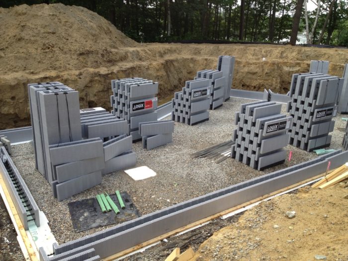

Image Credit: Roger Normand This photo was taken after the footings had been poured, but before the crushed stone was installed.
Image Credit: Roger Normand The foundation crew applied a coat of UGL Drylok on top of the cured concrete footings. The coating will act as a capillary break between the concrete footings and the concrete foundation walls. ICF blocks are made of expanded polystyrene (EPS), and are easy to cut with a hand saw. The blue strips of foam in the foreground are were placed at the bottom of the ICF walls to provide a thermal break between the concrete footings and the concrete walls. Unfortunately, the wrong foam was used; the foam was later replaced with high-density foam.
Image Credit: Roger Normand These strips of XPS were installed at the bottom of the ICF walls to establish a thermal break between the concrete footings and the concrete walls. The photo shows the regular-density foam which was later replaced with high-density foam.

We were very pleased to see a big semi-trailer lumber up Edgewater Lane to deliver our Logix brand Platinum series insulated concrete form (ICF) blocks.
ICFs are open-ended, hollow-core blocks made from expanded polystyrene (EPS) and plastic internal webbing; they will be used to build the foundation. They stack together like the Lego blocks you played with as a kid. Once assembled, linked with plastic zip ties and rebar, then filled with concrete, they offer a one-step foundation sandwich with a concrete core and a continuous layer of EPS foam on the outside and inside that provides insulation, a thermal break, and sound attenuation.
We received about 640 blocks in a mix of straight, taper tops, right and left 90-degree corners. (Corner block are not reversible – like most Logix blocks, they have protruding “male” nubs on the top and receiving “female” recesses on the bottom.)
Our block has a 6-inch-wide opening that will be filled with rebar and concrete, and 2 3/4-inch thick foam sides. The basic straight block is 16 inches tall and 48 inches long.
The blocks mechanically lock together vertically and horizontally; adjacent block are further joined with long plastic zip ties. Rebar is placed into the open center of the block before the concrete is poured. The rebar snaps into horizontal channels in plastic webbing inside the block, and is also placed vertically.
We chose the Logix Platinum series ICFs, which are made from Neopor EPS (a type of EPS that includes embedded graphite particles; the graphite boosts the R-value of the EPS by 23 percent). For the crew assembling the block on a bright, sunny day, the graphite particles also lend a much appreciated eye-friendly soft gray hue to the product, rather than the blinding white color on typical ICF blocks.

Laying foundation wall blocks
The foundation crew snapped chalk lines between the survey points on the footer and nailed lengths of 2×4 along the chalk lines for the entire outer perimeter. This gave them a hard, straight edge to quickly align the first course of block.
After the first course was installed, the crew nailed lengths of 2×4 along the entire inner perimeter of the block. (Note: this method does make it more difficult to adjust the height of the first course of block if the footers are not absolutely level. Our footers were set by transit, so that should not be an issue.) This inner and outer 2×4 blocking will prevent blowing out the bottom course of block when the concrete is poured. The 2x4s will be removed before backfilling soil against the foundation to eliminate a subterranean food source for termites.

Oops – that’s the wrong type of XPS
The foundation crew mistakenly installed 2 inches of regular XPS with a compression resistance of 25 psi rather than the required high-density XPS. Oops. No big deal, though, as only the first course had been loosely laid on the footers.
But we also needed clarification on which of three available types of high density XPS was required. Owens-Corning makes Foamular 400, 600, and 1000 versions, with compression strengths of 40, 60, and 100 psi. The answer was we needed the Foamular 600. But high-density XPS is a commercial, not a residential, product. The nearest vendor was some 50 miles away in Portsmouth, New Hampshire.
We need more rebar
Then we needed clarification on the spacing of rebar dowels that will be drilled through the high-density XPS into the footers, tying the footers with the foundation. This will lock the foundation in place so that soil pressure from freeze/thaw cycles doesn’t move the foundation wall out of plumb. (As an aside, this actually occurred in our home in Virgina, where a below-grade wall moved over 1 inch out of plumb.)
This question led our Logix supplier, Advanced Building Solutions, to review the spacing of the vertical rebar within the ICFs, which led him to review the size and spacing of all the rebar in the ICF wall. The result (based on Logix design tables): we needed thicker rebar, and lots more or it – some $2,000 in additional rebar costs! The dowels would be spaced with every other vertical rebar in the foundation, except along the narrow stairwell from the basement to the garage where it will match up with each vertical rebar.
How did that much rebar get missed? The design has not changed since January. It took several work days to re-engineering the rebar in the foundation. Meanwhile, the foundation crew moved on to other jobs.
We’ve been at a complete stop for one full week of ideal, construction-friendly Maine weather. Ugh.
But we’re glad to have caught the error while it could still easily be fixed.
