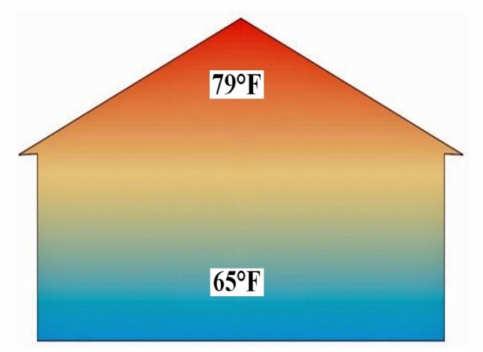

Let’s start with a simple example: a single-story slab-on-grade house with temperature stratification problems. The thermostat is 48 inches above the floor, and it’s set at 72°F. On a winter day, when you are sitting at your desk, the air near your feet is at 65°F. Up near the ceiling, the air is at 79°F. Why?
There are two main causes of this phenomenon.
Air leaks coupled with the stack effect. The most important factor in this type of stratification is air leakage. Holes near a home’s ceiling allow warm interior air to escape into the attic. As this air escapes, it pulls in cold exterior air through cracks near the floor — for example, cracks near the threshold of an exterior door. The engine for this type of air movement is the stack effect. Since the warm interior air near the ceiling is at a positive pressure with respect to the outdoors, it wants to escape. Since the cool interior air near the floor is at a negative pressure…
