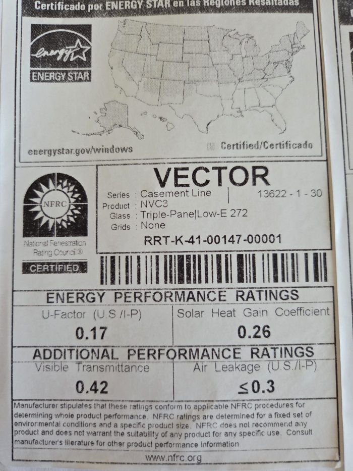

Any reasonably energy-aware designer, builder, or homeowner is likely to look at the U-factor, solar heat gain coefficient (SHGC), and air infiltration of any window system prior to specifying or purchasing a particular product. And while this does make sense when defining a window system’s energy performance, it doesn’t suggest how much consideration should be given to other areas of window performance such as condensation resistance, design pressure, or sound transmission performance.
Energy considerations aside, any homeowner who tries to look out of their windows, but can’t because the outer glass is covered in fog, or who has had to trust in the structural strength of their windows while watching and hearing wind and rain buffeting the glass during a violent thunderstorm, or being woken at 7 a.m. on an otherwise quiet Sunday morning to the sound of their neighbor’s lawn mower, might not be worried about energy performance at that moment. It is for such times that condensation resistance, window structural strength, or noise blocking, respectively, should be given some serious consideration.
