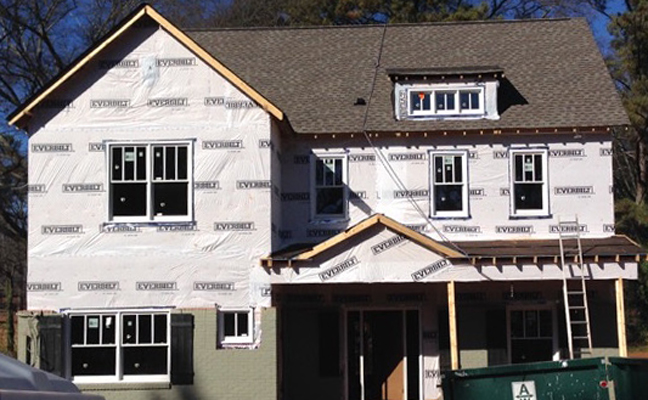

A water-resistive barrier (WRB) provides protection against water damage for water that gets behind the cladding of a building. But what if it doesn’t really resist water? I’ve written a lot about installation problems that can lead to compromised water resistance. (See the article I wrote last week, for example.) But other factors can make them leaky, too. Too much exposure to ultraviolet (UV) light is one of them.
At the Air Barrier Association of America conference in Baltimore last month, I attended a presentation by Marcus Jablonka of Cosella-Dörken. [Editor’s note: Cosella-Dörken is a manufacturer of water-resistive barriers.] The manufacturer has done a study of UV exposure to different WRBs, and the results should be of great concern to all builders, architects, and product specifiers. This is a preliminary study and there are still a lot of questions to be answered, but I’d be concerned if I were a builder.

Does your WRB get sunburned?
Exposure to ultraviolet light happens on job sites. Once you get the WRB installed, it’s sitting out there exposed to sunlight. Even on cloudy days, it gets UV exposure. (Ever gotten a sunburn on a cloudy day? I have.) The longer it sits there, the more it gets. But UV exposure also varies by location. Miami and Phoenix get a lot more than Seattle or Toronto. And it varies by time of year. Leaving a WRB exposed in winter won’t be as bad as leaving it out in summer.

Your WRB is showing
Of course, one of the key factors here is real-world exposure. The table below shows how exposure from the UV lamp relates to real-world exposure.
Five hundred hours of exposure to the lamp could be equivalent to as little as about 3 months exposure in south Florida or as long as 11 months in Toronto. One thousand hours of UV lamp exposure equates roughly to as little as 6 months in Florida or as long as 22 months in Toronto.
There probably aren’t many projects that leave the WRB exposed for two years. Three months, though, does happen occasionally. If you were using product B or E of the peel-and-sticks or product L of the mechanically-fastened, even at the 500 hour stage, the water resistance is down 90% for the former and 50% for the latter. So how much would it be down after one month? Two months?
Also, note that products B and E are labeled as having allowable exposures of 5 months, and the manufacturer of product L says you can leave it exposed for up to 12 months. After seeing these data, I wouldn’t be willing to take that risk.

The best thing builders can do to prevent problems from UV exposure is to get the WRB covered up as soon as you can. As you can see in the data above, even being left exposed for three months in Miami can cause a big drop in water resistance of some products. Just because some manufacturers claim their WRBs can be left exposed for 3 months or 5 months or 12 months doesn’t make it true.
