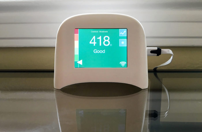

Until recently, measuring air pollution was a task that could be performed only by trained scientists using very sophisticated — and very expensive — equipment. That has changed with the rapid growth of small, inexpensive sensors that can be assembled by almost anyone. But an important question remains: Do these instruments measure what users think they are measuring?
A number of venture-capital-backed startup or crowd-funded groups are marketing sensors by configuring a few dollars’ worth of electronics and some intellectual property — mainly software — into aesthetically pleasing packages. The Air Quality Egg, the Tzoa and the Speck sensor are examples of gadgets that are growing in popularity for measuring air pollutants.
These devices make it possible for individuals without specialized training to monitor air quality. As an environmental health researcher, I’m happy to see that people are interested in clean air, especially because air pollution is closely linked with serious health effects. But there are important concerns about how well and how accurately these sensors work.
At their core, these devices rely on inexpensive, and often uncertain, measurement technologies. Someday small sensors costing less than $100 may replace much more expensive research-grade instruments like those used by government regulators. But that day is likely to be far away.

It turns out these sensors can work outside of your car, too. But they have some important limits. They are often not designed to work in the open air, where conditions are much cleaner than in vehicle exhaust. And they can be affected by conditions such as varying temperatures or relative humidity, or the presence of interfering gases that they are not designed to measure.
Sensor manufacturers sometimes provide limited information on these low-cost sensors, and it is very easy to use the devices improperly. This is because they are designed to work under very controlled conditions — for example, at fixed temperatures or with limited wind movement — and these requirements often are not communicated to consumers. Measurement accuracy is especially important when we are trying to understand how exposure to air pollutants can lead to health problems. If we rely on poor measurements and reach incorrect conclusions, we will fail to protect public health.

Some years ago we were building 28 new schools that required LEED IAQ certification. As the General Contractor we wanted to perform ongoing testing during construction (keeps contractors on their toes) but the consultant cost was, understandably, scary. So instead we spent the 10k on testing equipment, calibration gases and importantly, training.
What became immediately apparent was the incredible variation that seemingly small decisions could make on results. Height of sensor, proximity to doors, humidity etc. all played a huge role. The same applied when commissioning: even the best temperature probes were highly subject to location and operator consistency. The same issue was had with using CO2 sensors in HVAC systems: numbers were largely relative and it was the system operators experience that allowed refinement of set points.
So I am unsure how a consumer with a single point sensor and no knowledge will ever get 'usable' information beyond a numeric value. However what would intrigue me is a multipoint system, even if open source, that could be combined to give an overall 'picture' of conditions. Personally I'd love my HVAC to have the ability to ramp fresh air intake up and down dependant upon air quality......
The irony that transpired with the schools: indoor pollutants were FAR lower than outside due to the location in new subdivisions. Increasing 'fresh' air reduced air quality!!!!

OK, this whole discussion has really been bugging me for a while now. These consumer IAQ monitors are like a bike. The pro ones are like cars. Both are transportation, but a bike is a poor substitute for a car. It's unfair to ask the 0-60 of a bike. Likewise, if we expect consumer grade IAQ monitors to be pro ones, we are fooling ourselves.
Here's how I look at it. Until these came out, I had no idea what was going on in client homes. Now I have some idea, a low/medium/high kind of thing. Semi-quantitative, which is what Foobot at least calls their device. I can see when I hit a home run. PM, RH and VOC levels plummet. Temperatures stabilize. I get instant feedback that my design worked. (Or didn't.)
These things are inexpensive enough that you can deploy multiple units in one home.
I have 30+ Foobots deployed, they have taught me a ton. Pressurizing a house during spray foam keeps VOC levels at or below levels in a closed up bedroom. (CO2 is sensed as a VOC with metal oxide sensors.) Leaving it closed up took 4 days for levels to fall to normal while a client was out of town. Another client used Foobots to play with his dampers and managed to get his second floor cooler than the first after a bunch of air sealing work. It used to be a 10-15 degree split.
For mold sensitive clienst, their VOCs had been all over the map. With pressurization and a dehumidifier VOC levels flatlined. I had feedback from the clients that the house was radically changed, but now I had graphs for it too.
These are going to be very useful for marketing and they're in my upcoming case studies. They are nearly instantaneous evidence that what we do actually works. Transparent accountability. Considering how little uptake there is of serious Home Performance upgrades, I'm delighted to have a tool that helps show that I can actually fix things while others merely say that they do.
Think of these things like FitBits. FitBits are off +/-20% on steps. 20%!! Yet when you aggregate enough of them together, you get a good idea of what's going on. Manufacturers can calibrate them against each other. They become useful because of big data.
These things are potentially VERY useful tools. Let's stop pooping all over them and trying to figure out their 0-60s. Let's figure out where they can be useful instead.
