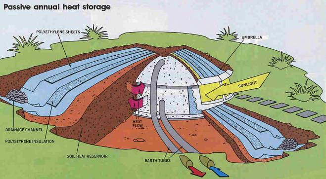

Earth-bermed houses built with the Passive Annual Heat Storage (PAHS) approach are a little off the beaten track for most builders and prospective homeowners. These houses go back a bit: John N. Hait described the construction of an early “umbrella house” in the 1980s.
As unusual as they may be, PAHS houses have their advocates. One of them is Laurel Davison, who is planning to build one in Missouri on a gently sloped lot with an unimpeded southern exposure.
In a Q&A post at Green Building Advisor, Davison outlines the basics of her proposed new house: a shell made by Terra-Dome Corporation, heated mostly with passive solar with a minisplit air-source heat pump for backup heating and cooling, and a variety of energy saving electrical appliances.
Davison sees several advantages to this approach, including little to no required exterior maintenance — not something she’d get with an above-ground house — and protection from tornados, always a threat in this region.
“Please review my plans… and pick holes in them,” Davison writes. “I don’t guarantee to change my mind, but I do promise to research varying opinions thoroughly and supporting data would be appreciated … I have an interested builder, land, money, and a quiet winter to get all the details addressed.”
The merits and pitfalls of this type of construction are the topic for this Q&A Spotlight.
No data to back up claims
“I hate to be the bearer of bad tidings,” writes GBA senior editor Martin Holladay, “but I am going to give it to you straight: You have decided to adopt a discredited approach to residential construction. The design approach you are discussing (the passive annual heat storage approach) has passionate advocates but little data to back up its claims. In those respects,…

PAHS are for the dogs
I've read through many websites, articles, and a few books on (in)different PAHS designs, and so far, I haven't found one that has a convincing (to me) description of how the heat flow and storage will work. I'd love to see one. There are at least four thermal aspects that PAHS needs to address, and one of more of them is missing from most descriptions. The four elements that I look for are 1) How much heat is stored, 2) How is the heat moved into the thermal storage, 3) How is the heat moved into the living space when desired (and prevented from moving when not desired), and 4) How much heat is lost to the surrounding environment.
PAHS designs often have extensive calculations on how much heat is stored. It’s pretty easy to demonstrate that many tons of earth can hypothetically store a lot of BTUs. Genuine, useful heat storage has to account for the extraction of that heat. Many descriptions of PAHS heat storage extoll the virtues of having surrounding soil that never goes below 55 degrees Fahrenheit. They seem to ignore the fact that infinite thermal mass at 55 degrees won’t heat a house to 65 degrees (without a heat pump). Yet some PAHS advocates don’t calculate the BTU storage correctly. I visited a PAHS house in Wisconsin, the home of an experienced solar contractor and builder, who had written a book about it, published by a major publisher. This author loved his house, and raved about it. He spoke about the many tons and cubic feet of sand, which stored his heat in the summer, and released it in the winter. As he described it, intuitively, it sounded great. Later, I used his figures, and calculated the actual heat storage capacity. If I remember correctly, he was storing about as much heat as you could with 1,000 gallons of water. Many of us can imagine that thousands of pounds of sand could store a lot of heat from summer over to winter. Yet few of us would think 1,000 gallons of water would be enough to heat a house through the winter, or even through a week of cold weather. We would be right in the second case.
On my second point, PAHS designs usually do OK. They have a credible mechanism for getting the heat into the thermal mass. They don’t always calculate well the changes in energy transfer as the heat in the thermal mass goes up, nor the rate of thermal conduction within the thermal mass. My third point is seldom satisfied by PAHS descriptions. A mechanism for getting the heat out of the thermal storage and into the house in a timely way isn’t well-developed. Often, it seems to be assumed that simple conduction between the surrounding earth and the walls and floor of the house will be sufficient for winter heating of the living space. For anyone who believes this, I would ask that you explain to me the following contradiction: Since you are collecting and storing heat during the summer, and using it during the winter, it seems likely that your maximum thermal mass temperature and stored BTUs will be reached in August or September. By the time you reach February or March, both the temperature and the total number of stored BTUs will be much lower. If enough heat will flow naturally from your thermal mass into the home to make it comfortable in February, how is it that you can keep your house comfortable in September, when the same thermal mass is trying to feed more energy to the home at a higher temperature, while the house needs less (or no) heat?
Many PAHS designs discount the importance of my fourth point, the heat lost to the surrounding environment. Often, this item is written off as negligible. While a few designs insulate the thermal mass on all faces, most assume that coupling to the deeper earth is an advantage, rather than a liability. In fact, migration of heat from the supposed thermal storage mass into the coupled surrounding earth is massive, in the most common PAHS designs.
I would welcome any links to a site or article that can address these four points in a clear, concise, and convincing way. In years of looking, I haven’t yet found one.

A few comments
Peter Yost says accurate modeling of insulation levels is impossible.
Modeling is just as possible as with any other system, but there's probably only one person who has taken the time to do it, and he certainly can't make a living off it (name supplied on request). As has been pointed out several times, high thermal mass houses are rare animals and do not interest commercial builders.
Peter also says that with "so many complex waterproofing details buried underground, you pretty much get just one chance to get it right."
On the contrary, if you install a Hait umbrella around your home you will be living in a ball of dry earth. Even if your buried membranes have rabbit holes in them your earth will always be dry because the slope above carries excess water to the peripheral drain and any damp going through holes will be insignificant. What Peter sees as a drawback is in fact the essential advantage, preventing rain from carrying away the heat stored in the earth and at the same time ensuring a dry environment for the home.
Malcolm Taylor can't see how PAHS can be DIY friendly: "All the critical parts of the build - the design to get the amount of heat storage correct, the concrete structure, the waterproofing and water management, the provision of services and venting - are all well beyond the domain of most DIYers".
As DIYers we are using reinforced concrete post and beam to give structural strength to rammed earth walls, all of which is extremely low-tech and good fun. With high mass construction in a conditioned and stable (under-umbrella) space, design is, on the contrary, far less critical. We are being careful with insulation and air-tightness on front wall and ceilings, and we will have a wood fire for backup and for the 24-month stabilization period, and that's it. With low-mass construction you have more critical design imperatives, ambient temperature being stored mainly in the air. You are obliged to model accurately.
David Ely's informative post says that PAHS seems like a lot of work and material for not much more advantage than he has with direct coupling and he'd want to see an example in operation about this time of year to see if there is any heat left in the insulated earth.
Fair enough, the lack of sensor data is frustrating to us too, which is why we have installed moisture and temperature sensors under the umbrella and will publish results in our blog, be they good or bad. But we have no reason to doubt the enthusiastic accounts of our rare PAHS contacts, and it seems obvious that an earth store protected from rain and heat loss will have a decided advantage, reducing and maybe eliminating the need for all that heating. We just finished three-quarters of our 20ft umbrella and berms at a total ( mostly DIY) cost of 3000 dollars, using mostly recovered materials such as used winter pool covers and theatre-prop polystyrene blocks. An inestimable advantage of the umbrella in our case is the added protection it gives to our buried rammed earth walls, which in turn give us good hygrometric qualities. Earth walls, at 872g/m2, have approximately 8 times the absorption capacity of concrete (70g/m2).
Derek Roff wants answers to four questions:
(1) How much heat is stored?
That depends on many different factors, so you're never going to get a definitive answer on this or on (4). Among them are:
-the difference between the temperature in the house and the temperature in the earth, which is one of the determinates of heat transfer speed
- the size of the umbrella,
-the moisture content of the earth,
-the physical properties of the earth. The idea of adding irrigation hoses under the umbrella to maintain humidity (and hence heat capacity) has been mooted,
-the conductivity of the wall material
(2) How is heat moved to storage?
The ambient spring, summer, autumn and even winter heat heat (yes, you can open windows in a high mass house, as David Ely mentioned) move into the earth through the interior walls, which is why open-plan is a good idea in PAHS and why inside doors should be left open when possible. This happens because heat always moves towards colder areas, so every time the inside temperature tries to rise higher than the mass the extra heat is absorbed by the walls. It is essential that this transfer area (wall and floor surface, plus ceiling if the house has an earth-covered roof) is as large as possible because heat transfer is extremely slow.
(3) How is the heat recovered and controlled?
Every time the temperature goes down in the house the transfer is reversed (eg heat moves to cold), and every time it goes up it does the opposite. No thermostat needed, the exchange is permanent. The store itself is unlikely to overheat, because its heat is moving through the earth at approximately 3ft per month in summer towards cooler areas outside the umbrella. Even when the store is at its warmest in the summer the house is also at its warmest, and heat just doesn't move towards... heat. The result is a stable interior environment, and that's what Derek's builder/author friend seemed to find also. (What is the title of his book Derek?) According to Hait, the overall heat level can be regulated over a long period by allowing summer temperatures inside the house to rise or fall by using shutters or other shading or opening or closing windows and doors.
(4) How much heat is lost? As in (1) that too would depend on many factors, which is one of the reasons non-specialized architects and engineers are wary of PAHS. Whatever the figure, it can't be that significant if what PAHS owners tell us about comfort is true.
