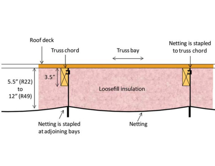

Experts usually advise builders that you can’t install fiberglass insulation directly against the underside of roof sheathing. If you want to install fiberglass between your rafters, you have two basic choices: either include a ventilation channel between the top of the fiberglass insulation and the underside of the roof sheathing, or install enough rigid foam above the roof sheathing to keep the roof sheathing above the dew point during the winter. These rules were developed to prevent damp roof sheathing.
Most building codes (including the International Residential Code) allow just one exception to these rules: in Climate Zones 2B and 3B, you can install fiberglass insulation against the underside of your roof sheathing without a ventilation channel or rigid foam above the sheathing — but only if you install tile roofing. (This system works because concrete tiles and clay tiles are well ventilated and vapor-permeable, so any moisture that accumulates in the roof sheathing can dry toward the exterior.) The code exception can be found in section R806.5, subsection 5.2, of the 2012 IRC. (Of course, if the owner of such a home decides to re-roof with asphalt shingles, the roof sheathing may begin to rot. But that’s another story.)
Owens Corning, a leading manufacturer of fiberglass insulation, is now promoting a package of products — basically blown-in fiberglass insulation and a new type of insulation netting — to create unvented conditioned attics. Owens Corning calls this proprietary insulation method the “ProPink High Performance Conditioned Attic System.”
Surprisingly, Owens Corning is promoting this approach for unvented roof assemblies without any rigid foam above the roof sheathing. Does this make any sense?

Vapour retarder netting
I'm having trouble visualizing how you would keep a continuous vapour retarder when it is going to be penetrated by the webs of all the trusses. The two dimensional diagram of the system avoids showing that intersection.
The manufacturer faces even more hurdles up here north of the border where our code takes an either/or approach to insulating above or below the roof sheathing.
Response to Malcolm Taylor
Malcolm,
Take a look at Image #4, which shows a completed installation. The visible fabric with the red letters on it is the insulation netting we're talking about; that netting is available in a version that had a low enough perm rating to be a vapor retarder.
I don't know why you are having trouble visualizing this layer as continuous. It certainly looks continuous to me -- much more continuous than is necessary for a layer to be considered an adequate vapor retarder.
Owens Corning makes no claim that this netting is an air barrier. The air barrier is elsewhere -- it consists of the roof sheathing and the canned spray foam used to seal leaks in the roof sheathing.
Penetrations by web truss members might be considered tricky to seal if this layer of fabric were intended as an air barrier. However, a vapor retarder that covers only 95% of the area in question is 95% as effective as one that covers 100% of the area.

Malcolm - I think you're letting Martin off the hook a bit too easily. The photo does not show where the webs drop down from the top chords, it shows only the chords. It would be exceedingly time consuming to make those junctions air or vapor tight.The air is carrying the moisture,and it is important, in all but the driest and warmest of climates.
Kevin.
With or without the webs, to me the system works against the inherent advantages of a trussed roof. Whether it's spray foam or this netting you are fighting against the characteristics of what as designed to be a large cavity, full of structural members, best insulated on the bottom.

You make a good point that truss webs will complicate the installation of the netting. I don't think this issue has anything to do with vapor retarder effectiveness, though. Rather, it has to do with how difficult it will be for contractors to install the netting.

Truss Penetrations
The linked presentation shows more detail on the system's installation and how trusses are penetrated at the netting seams.

It actually doesn't look that hard to work around the webs. Reservations about the whole idea of blowing fiberglass against the sheathing aside, the system has some smart details..
