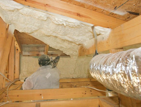

Open-cell polyurethane foam expands dramatically as soon as it hits its target, rapidly filling wall cavities and typically mushrooming beyond the stud line. After it’s firmed up, installers trim away the excess so drywall or other wall finishes can be put up.
The installer who sprayed open-cell foam into the exterior walls of Peter Halkias’ house has packed up his truck and hit the road, leaving him with “bags and bags” of excess foam. Halkias knew up front that disposal would be his problem. Now he wonders what to do with it, and whether it can be broken up into finer chunks and spread over the fiberglass batt insulation already in his attic.
“Are there any code violations involved in doing this?” he asks in a Q&A post. “The only thing I can think of is an issue of flammability. The attic is fully vented and any light fixtures located in the ceiling joist bays are rated IC and airtight. I am trying to kill two birds with one stone: Get rid of the waste and add some insulation R-value to my attic ceiling.”
The replies to Halkias’ post, the subject of this week’s Q&A Spotlight, touch not only on the merits of his plan but also the knotty disposal issue in general. And like a concurrent thread elsewhere on the site, it’s an opening to discuss the potential downsides to spray-foam insulation.
First, will it work?
GBA senior editor Martin Holladay doubts much will be gained by Halkias’ plan. First, exposed foam is a fire hazard, Holladay said, and used in this way it won’t offer much in the way of insulation: “Unlike undisturbed foam that is sprayed in place,…

Our industry has been looking for the magic answer as to what to do with open cell cutoffs, and in fact, there is a current article in Spray Foam magazine dealing with this issue. I hope as the problem is discussed further, someone does find a solution. My primary concern of course is that anything that lands on the floor does so at great cost to the contractor, as the typical 3500sf home sees hundreds of dollars worth of material (OC) go in the dumpster, in the form of offcuts.
As for leaving jobsites with all of the cutoffs, it's virtually impossible, and anyone who expects a spray foam contractor to do so on every job lacks intimate knowledge of the business of an SPF contractor. Spraying a different large job every day generates enough waste that the contractor would need a full time waste disposal crew with truck(s). Then the foam would end up being disposed of through the same channels as the homeowner or GC would, so we'd all rather pass the savings along. If we're asked to take it, by all means, we'll arrange a dumpster at the jobsite's expense, but just about every person I've met would rather not pay hundreds of dollars for this service. And I would hope to be spared the argument that only multimillion dollar businesses with full time garbage crews, multiple dumpsters, etc. should engage in spray foam. Small businesses, besides being the lifeblood of the country, bring a wealth of experience, knowledge, and personalized service/attn. to detail to the table that most larger competitors can't match.

The fact that you feel that removing the waste generated by your work from the job site would be "virtually impossible" doesn't speak well of the industry.
When I worked as a contractor, I was responsible for all the waste generated on the job site, and I expected the same from other contractors working there. Like you, I hope that "someone finds a solution" to this problem. In the meantime, I think two first steps would be for contractors to endeavor to minimize the foam that expands beyond the studs, and to take responsibility for cleanup and disposal.

Why can't these scraps be placed in a cavtiy/bay and sprayed over?
Response to Mark Brannkarr
Mark,
You asked, "Why can't these scraps be placed in a cavtiy/bay and sprayed over?"
1. Most spray foam installations are in wall cavities or sloped ceilings, where gravity would prevent your proposal from being carried out.
2. While your proposal would work on an attic floor, most attic floors are insulated with less expensive insulation materials like cellulose.
