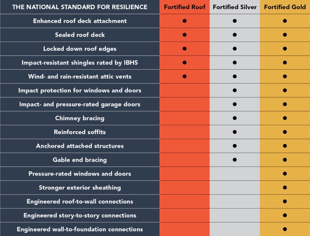

Three Types of Fortified
Fortified standards include three designation levels for both new homes and retrofits. Each level builds on the last and includes additional improvements for increased resilience against natural disasters.
