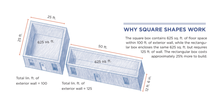

While buildings are not animals, they have area, volume, and a perimeter. Floor plan configurations require a ratio of exterior wall areas to interior volumes. To run a thought experiment, I drew two figures, one a square and the other a rectangle, both with an area of 625 square feet. Then, I calculated the perimeter of both shapes to discover that the square had a perimeter of 100 linear feet and the rectangle enclosing the same area had a perimeter of 125 linear feet. This was my eureka moment, as I realized the square shape would cost less to build because it had 25 percent less exterior wall—with its many costly layers of insulation, sheathing, water-resistive barrier, and siding.
I experimented with different shapes and sizes using a computer program to tweak building designs. Sometimes squares weren’t the most cost-effective option because they became too large for standard materials. However, my experiments showed consistent results.
One challenge was that I often had to build on narrow lots, requiring long, thin houses. So, I adjusted my formula to compare the area of the floor to the area of the exterior walls. This gave me a more precise ratio. Ideally, the ratio should be one-to-one, but that’s geometrically impossible unless you’re building a sphere. When I compared the square and rectangle examples using this new method, the square had a ratio of .78, which is good. Still, I found an even better ratio with a specific rectangle design: 24 ft. by 34 ft., which yielded a ratio of .88. If you run my earlier example, considering the wall area instead of the perimeter, you end up with a more accurate comparison.
My example of the square: 625 sq. ft. ÷ (25 ft x 4) x 8 = 800 sq. ft. wall = .78
And the rectangle: 625 sq. ft. ÷ 1000 sq. ft. wall = .62
My go-to shape is 24 x 34: 816 sq. ft. floor ÷ 928 sq. ft. wall = .88
The square yielded a ratio of .78, which is efficient, but I could improve on this even with a rectangle. I discovered that my tried-and-true footprint of 24 ft. by 34 ft. yielded a very respectable ratio of .88 sq. ft. of floor for every square foot of wall.

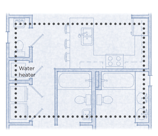

Once I have decided on my basic box, I locate the utility core as close as possible to the center of the house, moving it around only as required to design a livable floor plan. This location makes for shorter runs of costly ductwork, plumbing, and heavy electrical wiring. I recently began using Gary Klein’s “hot water rectangle” to analyze my plumbing layout. Klein aims to reduce time waiting for hot water to arrive at the faucet. His approach and the ratios he recommends help optimize plumbing locations to reduce the cost of water and sewer pipes much more than simply locating bathrooms back-to-back.
Hot Water Triangle
Gary Klein surveyed typical plumbing layouts and discovered ratios of 67% (very efficient distribution) to 155% (extremely inefficient distribution). Klein found that clustering wet rooms and locating the water heater near the cluster resulted in savings of more than $2000 in the cost of the plumbing system. This drawing was adopted from a design by DPZ Codesign.

    It's surprising that a non-square rectangular (henceforth just "rectangular") house could have a better floor/wall ratio than a square one, but the reason for it in this case is that the rectangular one is bigger. For a fixed floor area a square will always have a better ratio, and this ratio is unbounded. For the 24 x 32 example, a square with the same area has sides of length sqrt(816) = 28.6 ft. The wall area in this case is 914 sq ft--smaller than the 928 sq ft of the rectangle...but basically the same. The rectangle is still probably the better shape for other reasons. But note that a 32 x 32 house would have a ratio of 1. A 64 x 64 house would have a ratio of 2...but might a bit weird or expensive for other reasons.

  12. LongRunHeatPumps | | #19
    Thanks for the article. Reading this, and your 2002 article in Fine Homebuilding, is like looking at our own home, which was built in 1982 by a large cost-conscious builder. It's a two level rectangle- 40'x27' bi-level(split foyer) with full brick up to the gable and 2"x4" exterior walls above grade. Underneath the brick is a 1/2"- 1" air gap and then foil skinned foam panels attached to the 2"x4" walls, with appropriate bracing. This results in a wall assembly with an R value of app. 22, which is great. Our house also survived a 5.0 earthquake in 2002 without damage.
    Our home is 200 amp all-electric, a consequence of gas shortages in the late 70s & early 80s. It's not a problem as it's very energy efficient and low cost with a good variable speed heat pump. We used 6,264 kWh last year, for the two of us. Our kids are grown and gone. The power company replaced the 44 years old buried neighborhood power lines in '22, but they left our shared, original 175 kVA transformer in the corner of our 1/4 acre lot.
    The 5.5 kW tank water heater and air handler are located in lower level center, so short copper water line and plenum/duct runs. The hot water rectangle is 7.6%. By doing this rectangle calculation, I realized that our home's livable area is only 1,991 sf. The assessor and real estate people go by the exterior dimensions of 2,160 sf.
