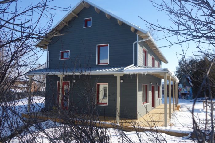

The genius of Passive House design is that it recognizes the building itself — its skeletons and skin — as a technology. Passive House innovation therefore involves both performance and cost, Ã la other clean energy technologies. Powered by modern building science, energy modeling, and an advanced analysis of the thermal properties of building structures, Passive House architecture sits squarely in the realm of information technology and science-based innovation. That is a potential game changer for buildings’ role in the clean energy transition.
Cost-neutral passive house design emerges
Many Passive House projects today are approaching cost parity with conventional construction. When a significantly better product becomes available for little or no extra expense, then mass adoption becomes possible. When Passive House buildings become commonplace — as they are in Europe and as is beginning to happen in Vancouver, B.C. — then the negawatts generated by this stock of ultra-efficient buildings can truly help power the grid. Future electric vehicles can be powered by the negawatts, enabling Passive House architecture to reduce emissions from both the building and the transportation sector.
Recent research by the Grantham Institute at Imperial College of London suggests that the market impact of the declining price of solar energy and electric vehicles could significantly curtail demand for fossil fuels and limit warming to between 2.4°C and 2.7°C, when combined with reasonably strong climate policy. To hit the 2°C target, the research team says that decarbonization of buildings will be vital.
The need for bold climate solutions is urgent, especially given federal intransigence. The good news is that we as designers, builders, and building owners have the means to act on the local level, building by building. Now is the time — our collective future may well depend on it.
