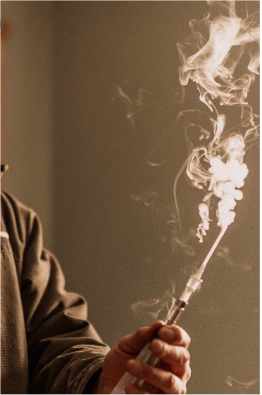

Using smoke to see the movement of air is another method for detecting leaks. Either positive or negative pressures inside a home can direct air currents away from or toward the leak. A small amount of smoke is often all that is needed. (TEC and Retrotec both supply tools that produce smoke.)
Fog Puffer
Smoke generated by TEC’s Fog Puffer, a cross between an e-cigarette and a turkey baster
