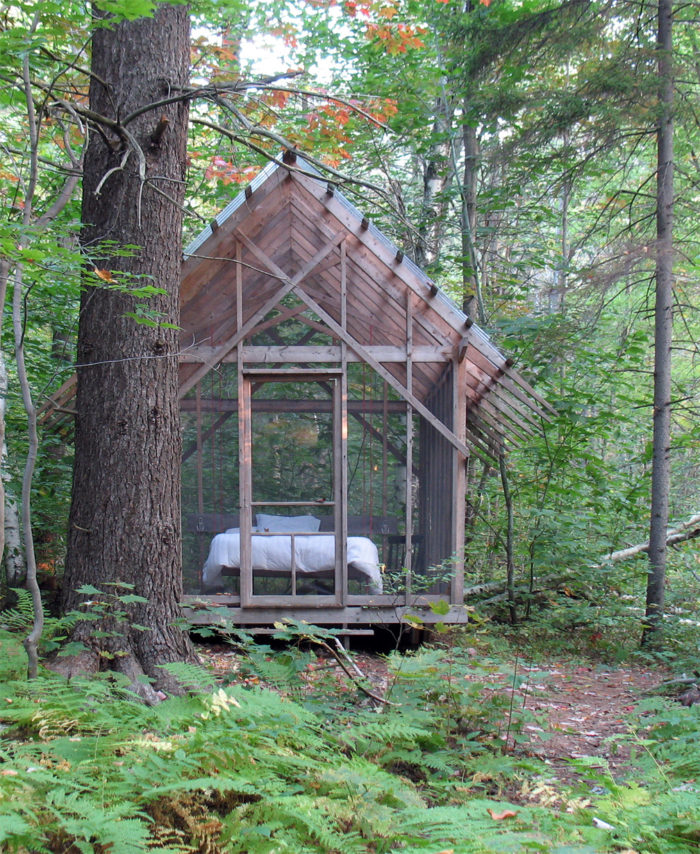

Fern House
Robert Swinburne's Fern House, which started out as a tent platform and evolved into something else.
Image Credit: Robert Swinburne
