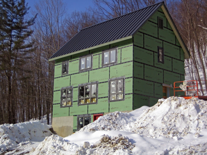

Up Hill House:
The blog chronicles the construction of a “net-positive” house in upstate New York by two self-described city folks looking for a different life.Image Credit: Jill and Larry Burks
Larry and Jill Burks are self-described city folks building a house in upstate New York. It’s not any old house, but a 1,200-sq.-ft., superinsulated home that they hope will generate more power than it consumes in a year — a “net-positive” house.
Their blog, Up Hill House, is the step-by-step story of how the house gets built, beginning in June 2008 when they bought 50 acres of land and a cabin near the town of Cambridge, N.Y.
The couple had been looking for a place in New York City, but the best they could do was a 400-sq.-ft. apartment in Brooklyn that was on the market for $400,000. “Maybe it was my years of studying architecture, but I could not see spending the next 30 years paying a mortgage on a small soulless apartment with no redeemable architectural character,” Larry writes. “Not to mention no outdoor space. That’s when it hit me. This is crazy! There has to be another choice.”
This change of direction helped launch their project, described in dozens of entries over the last 33 months. Larry offers an extremely detailed look at how the house was planned and how it’s being built, writing about everything from window selection to sitework and heating options. The tone is expert. It turns out that while Larry has an architecture degree, he designs “easy to use Web applications,” not houses. The couple has already moved out of New York to be closer to the project, and will live in the house fulltime once it’s completed.
The two-bedroom, one-bath house should be finished in May, if all goes according to plan, and come in at about $142 a square foot. The house comes with R-44 walls and a R-75 roof, along with a 6.9-kW photovoltaic array.
The blog can be read in two ways, either chronologically or by topic. So, if you want to follow the project as it unfolds, just start with Larry’s June 2008 post and work your way forward as the couple develops plans for the house, clears the site, and sees the house take shape. If you’re more interested in specific topics, such as windows and doors (11 posts), energy calculations (eight posts), or the foundation (eight posts), Larry has made that possible, too.
It’s an engaging mix of technical and non-technical information, both personable and informative. And it gets to the inherent complexities of building a high-performance house.
