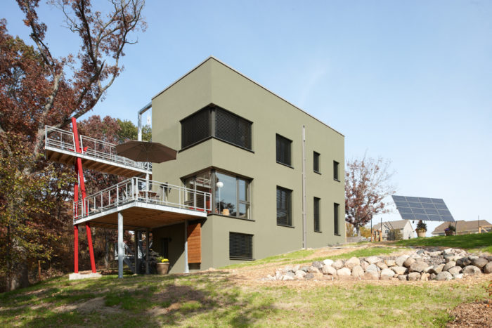

Passive House in the Woods
Tim Eian designed this net-zero energy house, the first certified Passivhaus in Wisconsin, and explores its features in detail on his two blogs.Image Credit: Tim Eian
Tim Delhey Eian is a German-trained architect and Master Carpenter whose Minneapolis firm, TE Studio, specializes in Passive House design. His blog, Tim Eian is, unsurprisingly, about all things Passivhaus.
The Passivhaus (or Passive House) standard, which originated in Germany, sets extremely strict performance limits for energy consumption and air tightness. Eian is a certified Passive House consultant who designed the first certified Passivhaus in Wisconsin, a project called Passive House in the Woods. (GBA has published two stories on the Passive House in the Woods project: one in May 2010, and another in October 2010.)

The project clearly represents a major effort for Eian’s company and the many experts that collaborated on it. The net-zero energy house measures 1,900 sq. ft. and has R-70 walls, an R-95 roof, and an R-60 slab. It is heated with solar energy and electric floor mats. It’s an uber-project in every way.
The site gives an excellent description of how the project developed, with some snappy graphics showing power consumption, power production from its photovoltaic array, and its carbon footprint. It also includes entries from a number of project players, including Eian, the homeowner (a local physician), and the builder. If you’re interested in plumbing the depths of how these houses are built, this is a good place to visit.
