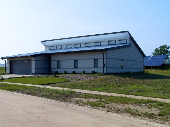

Equinox House
This all-solar, net-zero energy house in Urbana, Illinois, is the subject of a blog by the same name by Ty Newell, a professor emeritus at the University of Illinois Newell's solar energy credentials stretch back to the 1970s.Image Credit: Ty Newell

“Equinox House is one of the most technologically advanced homes ever built. But if you visit Equinox House, you will not see the complexity nor be aware of it. You will experience a simple house that exists to serve its occupants and keep them comfortable. The complexity of its engineering design and Equinox House’s embedded technology, paradoxically makes it a very simple home to live in.
“Today’s automobiles are similar with their highly sophisticated technologies. And yet, today’s cars are simpler and safer to drive, with repairs and maintenance less frequent than ever before. Equinox House has incorporated sensing and control technologies that simplify living in the house. Even with a failure of the local utility, its robust design ensures that water pipes will never freeze, and that it will be a comfortable shelter in either summer or winter. And, because it is a true, net zero home that is 100% powered by solar energy, future increases in utility rates will not be a concern.”
On the paradox of windows
“Equinox House is a modestly windowed home. At the same time, the windows have been designed to brightly light the interior throughout the year, and efficiently provide solar heating in the winter. The house is named after its novel ‘equinox overhang’ that protects the clerestory windows from the summer sun while acting as a solar radiation reflector during the winter.

I remember reading through most of this blog last year. I found it interesting how they used their window selection and type. Fairly standard Pella windows made it into the project instead of the often recommend triple glazed higher performance windows found on this forum. Some of my cost comparisons have also been finding using the Pella fiberglass window with the Sun glass is a really high performer when compared to its price, especially against a triple pane, high SHG window. There appears to simply be no pay off going that route.
