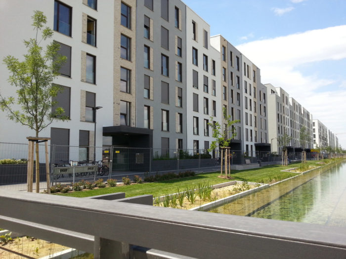

Germany’s Passivhaus Institut (PHI) says an entire housing district in the city of Heidelberg has met the stringent heat-energy requirements of the Passivhaus building standard, demonstrating the standard can be deployed on a large scale.
Measured energy consumption in the 1,260 housing units in 2014 averaged 14.9 kWh per square meter, a whisker under the 15 kWh/m2a standard required for Passivhaus certification. The units totaled more than 75,000 square meters (807,000 square feet).
The residential project in the Bahnstadt district of the city, which PHI calls the largest Passivhaus settlement in Europe, was built by different developers and architects, showing “convincingly” the building standard can be applied to wide swaths of construction, not just single buildings, according to a PHI announcement.
The amount of energy used for heat in these units was about 20% of what would have been used in conventionally built apartments, PHI said. It posted a full report online.
