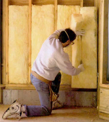

Is a building inspector justified in insisting the kraft paper facing be removed from fiberglass batt insulation because of mold potential, or will that actually cause moisture problems?
A building inspector has ordered the removal of the kraft paper facing on fiberglass batt insulation before it can be installed in the exterior walls of a bathroom. Will that increase the risk of moisture damage in the walls?
Image Credit: Fine Homebuilding magazine
Josh, a builder in Columbus, Ohio, has been hired to add a bathroom in the attic of an existing house. Although he had hoped to use cellulose insulation in exterior walls, the homeowner’s budget allowed fiberglass batts. Josh was counting on the kraft paper facing on the insulation to serve as a vapor retarder, but to his surprise the building inspector insists the paper be removed before the insulation is installed.
What gives? And will the inspector’s decision increase the risk of moisture problems in the bathroom, surely one of the most humid rooms in the house?
The Q&A discussion actually provided some support for the misunderstood inspector, as well as a look at materials and building techniques that will keep moisture problems at bay.
Will water vapor rot the walls?
Between tub and shower, sinks and toilet, a bathroom has a high potential for water damage, not only from leaks of liquid water but also from water vapor that can collect inside exterior walls and condense. Vapor retarders are there to slow the diffusion of moisture, so the building inspector is off base, argues senior editor Martin Holladay.
Even so, Holladay adds, vapor diffusion is rarely as big a problem as we might think. If the inspector’s ruling underscores an “incomplete understanding of building science,” it’s probably not going to have a serious practical effect. This is one battle that’s probably not worth fighting.
Robert Riversong isn’t so sure the inspector is wrong. Paper facings on conventional gypsum drywall provides food for mold. Riversong notes that the tiled portion of the wall will include a Schluter-Kerdi waterproofing membrane, so removing the kraft paper may have a double benefit: reducing the chances for trapped moisture by having one rather than two vapor retarders,…

    Either exterior or interior rigid foam will solve the problem of inward solar vapor drive.
    The topic has been debated for decades, but I think it has been fairly definitively resolved in favor of exterior foam, which has the following advantages:
    1. It doesn't take up interior square footage.
    2. It addresses thermal bridging at rim joists.
    3. It easily addresses partition intersections.
    With all these advantages, it's hard to make a strong argument in favor of interior rigid foam.

    Four of the products you mention -- EPS, XPS, polyiso, and closed-cell spray foam -- are vapor retarders, to varying degrees. When using any of these products, no further vapor-retarding strategy is necessary.
    Open-cell spray foam, however, is fairly vapor permeable. In a cold climate, an interior vapor retarder is recommended when using open-cell spray foam. Since open-cell spray foam is vapor permeable, all of the usual precautions need to be taken to ensure than inward solar vapor drive does not cause problems.

    The inspector was right in his application of the code, (IRC R702.3.8), as long as he considered Dens Armor Plus conforming to ASTM C 1178. GP does not say this product complies anywhere in the technical literature, and further, this from their technical manual: DensArmor Plus panels can be used as a tile backerboard in dry areas or areas with limited moisture contact such as areas
    adjacent to sinks and toilets, bathroom ceilings and areas above tile in residential shower areas. In wet areas where 2006 IBC
    and IRC codes have been adopted, Georgia-Pacifi c Gypsum recommends the use of DensShield® Tile Backer, which incorporates
    a built-in moisture barrier in wet areas. The WPM over DensArmor Plus likely is a great system, but GP will not stand behind any failure. The larger question is well detailed; how well do codes reflect sound building science? Not always well, but don't kill the messenger. The inspector was right on.

    As noted by TC Feick, above, Section R702.4.2, and R702.4.3 (section numbers in my '03 IRC) prohibit application of "Water-resistant gypsum backing board" "over a vapor retarder in in a shower or bathtub compartment." So, the official was probably within his competence to request removal of the Kraft paper. (Of course, the code does not explain itself and say what theory this prohibition is based on.)
    However, I agree with Martin Holiday that at the end of the day, it makes little difference whether the Kraft is there or not, because the Kraft paper has such a high permeability that it scarcely qualifies as a retarder. The ASHRAE handbook lists the Kraft paper permeability as about 30 times greater than that of 6 mil polyethylene (wet-cup test). Plus, to a tiny water vapor molecule, the fish mouths, tears, and staple holes normally seen in the Kraft paper look like the grand canyon and offer ample "end runs" around any limited resistance to vapor flow the undamaged sheet may have.
