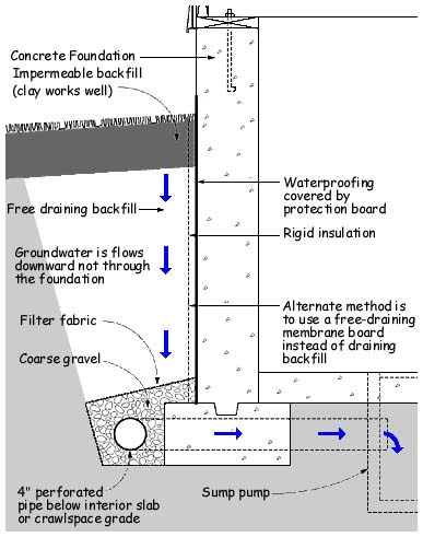

Scott Razzino has an all-too-familiar problem. The basement of his 1,100-sq.-ft. home in Atlanta is chronically damp. He’s installed a 65-pint dehumidifier, which must be emptied every day. Surely, he wonders in this Q&A post, there must be a better way to tackle the problem.
Razzino reports that the house is about 26 years old and has a block foundation. He’s routed gutters away from the house and sealed air leaks in the walls with mortar and concrete sealant. The basement doesn’t have a sump pump.
Short of installing French drains around the house, along with a sump pump, is there anything that can be done?
The first step, says Robert Hronek, is to figure out the source of the moisture. He suggests taping foil to the wall in several spots and waiting to see whether any condensation appears.
“If the water is trapped between the wall and foil, then it is coming through,” Hronek writes. “If there is condensation on the outside of the foil, then the moisture is from air leaks.”
If moisture is migrating through the block, adds Robert Riversong, sealing the surface with two coats of UGL Drylok masonry sealer “will make a major difference.”
The manufacturer claims that Drylok’s breathable film won’t trap moisture in masonry and will withstand 10 lb. of hydrostatic pressure, “greater than a wall of water 22 ft. high.”
“Drylok is the only foundation waterproofer I will use, and it’s excellent for a capillary break between footings and foundation wall on new construction,” Riversong says. “I’ve used it to seal the interior of site-built CMU composting toilet chambers (over surface-bonding cement) as well as the exterior of exposed chimney block.”

In the Northeast we know how to install proper foundation perimeter drains because their purpose is NOT to evacuate surface water - that's taken care of with overhangs, gutters, leaders, grading and swales.
In much of New England, seasonal high ground water prevents the installation of in-ground septic systems. That also means that seasonal high ground water may be precariously close to the footing and basement slab level. Perimeter drains are designed to evacuate rising ground water, which is why the holes are on the bottom of the perforated pipe.
So all the above-ground mitigation may not be sufficient to alleviate a wet basement and, just as gutters are preferable to surface drains as a first line of defense, an exterior drain is far preferable to an "after-market" interior drain as the first line of defense against wet basements.
You'll notice in the image I linked to (http://www.hipspro.com/webart/footing-perimeter-french-drain.jpg), there is a relatively impermeable cap layer of soil over the course aggregate backfill so that ground water but not surface water finds its way to the perimeter drain. The course backfill also alleviates hydraulic pressure on the foundation as the soil becomes saturated.
One questionable detail in the foundation drain image at the beginning of this blog post is the transverse drain through the footing. A properly installed perimeter drain should prevent ground water from rising up under the basement slab and the 4"-6" of sub-slab stone will serve as a capillary break, assisting the sub-slab vapor barrier in keeping the concrete floor dry. But, for a radon vent at the inside perimeter of the foundation to function properly, it cannot be tied to an outside perimeter drain to daylight. The radon stack, connected to the inside perimeter piping, is designed to induce a negative pressure under the slab to draw soil gases out. A short-circuit to daylight will undermine this negative pressure zone.
If daylighting of the footing drain is impossible due to flat topography, then a transverse connector through the footing will empty the drain into a gasketed radon-proof sump, which is NOT connected to the interior radon drainpipe or to the subslab stone.
With rectification, as with new construction, the most reliable way to keep a basement dry is to dig out around the foundation to the footings, install a proper perimeter drain, cove the wall/footing joint with hydraulic cement, waterproof the exterior of the foundation, and backfill with well-drained mixed aggregate covered with a soil cap. I did this on a 1965 cape I owned and it effectively stopped what had been a spring-time stream running through the cellar.

Chandler's detail
Michael Chandler- would you mind sharing a sketch of the detail you mentioned:
"Placing the footing directly on the waterproofing where it coves out from the foundation wall onto the footing". Something about that wording isn't clear to me. I'm designing/detailing here in NC too (the western side) and would like to fully understand what you have found successful in our area.
that detail
There are some photo's here that show what I'm talking about. the Footing DRAIN is placed directly on the waterproofing where it coves out from the foundation wall onto the footing.

detail drawing
just a comment/question:
I continue to see footing/foundation details drawn with a keyway cast in the top of the footing.
I have not seen that detail actually installed in over twenty years, and have never seen it in production building. This engineered connection has been replaced by cast in place rebar.
Is anyone out there including this detail or is it time to start revising these dated drawings?
