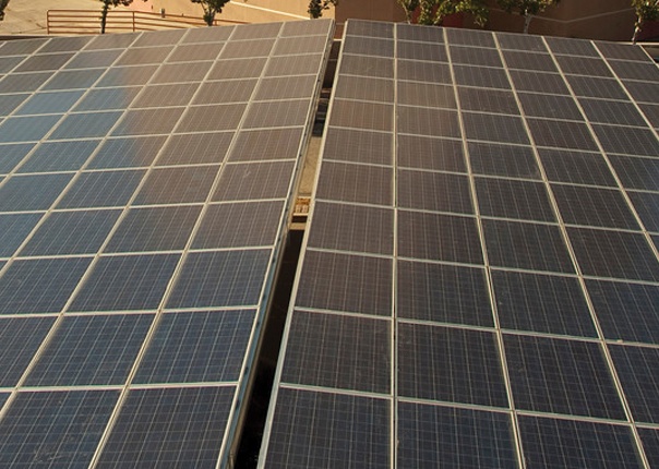

The growing number of rooftop solar installations means new potential hazards for firefighters and may prompt changes in how effectively fire departments can battle certain fires, according to a recently revised report from The Fire Protection Research Foundation.

Firefighters can run into these problems even on the small arrays they’d typically find at a single-family house, but as the number of modules increases, so does the potential for trouble.
For example, Reuters reported on a fire in New Jersey in September in which PV arrays prevented firefighters from getting on the roof of a luncheon meat warehouse. It took 29 hours to put out the fire, and the Delanco, N.J., deputy fire chief said the outcome could have been different had firefighters had ready access to the roof.
