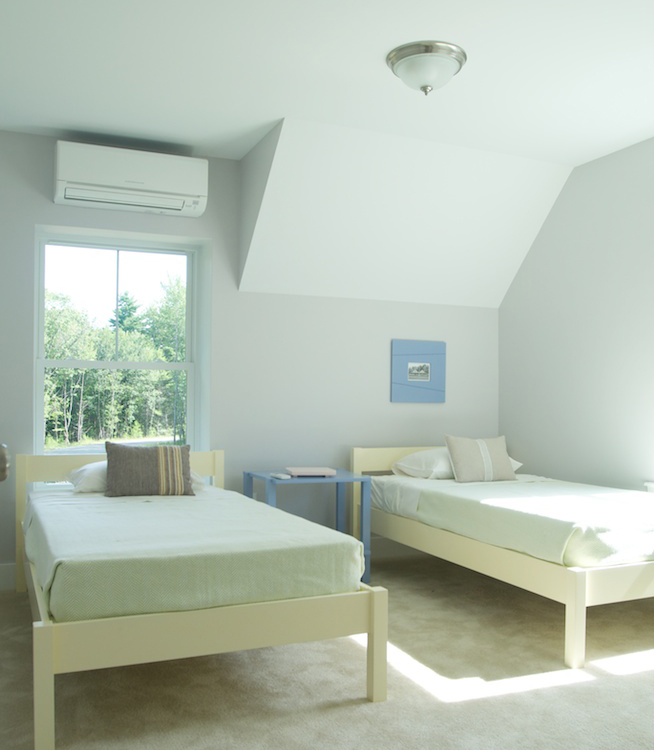

John Bell, building a 3300-sq. ft. house in eastern Pennsylvania, is weighing his options for heating and cooling, and it comes down to a conventionally ducted air-source heat pump or a multi-head ductless minisplit system made by Fujitsu.
Bell sought several quotes from contractors. The first proposal, parts of which gave Bell pause for thought, was for a 5-ton conventional heat pump. A second HVAC contractor thought that a 2.7-ton system would be enough. So Bell went for a third opinion and so arrived at the ductless minisplit option.
His real dilemma is deciding how to configure a ductless minisplit system in his extremely well insulated house. One bid includes seven minisplit heads.
Each of the heads would be connected to its own compressor outside, and Bell says both he and his wife have no problems with that. Nor will they mind looking at all those fan units on interior walls. He does wonder, however, whether this plan makes any sense.
“It might be overkill with that number of units,” he writes in a post at GreenBuildingAdvisor’s Q&A forum. “I will be ventilating the house with an UltimateAir ERV. I would like to go with the minisplits for the whole house, but I don’t know anyone who has used them.”
Any advice?

Oversizing mini-splits only benefits efficiency to a point...
Up to about 1.5x oversizing for the design-condition load of a zone a mini-split gets a pretty good efficiency boost since it still modulates output and only experiences short cycles when the outdoor temps are high (=higher efficiency). This is oversizing is derived by the compressor & blower spend most of operating time at lower speeds, which is much more efficient than at the highest speeds across temperature. See Figure 5 , p18 (.pdf pagination) in this document:
http://www.nrel.gov/docs/fy11osti/52175.pdf
But when the unit is so oversized that it can't modulate output low enough to match load, and is spending a significant fraction of it's time idling, the standby time isn't free, there is still real power being burned. As understand it, keeping the compressor up to temp for safe startup and keeping the remote-control receivers active takes at few 10s of watts per unit, and can average more than 50W per unit during freezing weather just to keep the compressors happy. That power that is expended outside the house, and is not even offsetting the space heating load at a paltry COP of 1- it's a total write-off!
Seven tiny 3/4 ton mini-splits would have a combined rated output of 63000BTU/hr, which is probably 2x or more the actual heat load for the whole house, and for the smallest & lowest loss rooms a 9000BTU unit could easily be 5x the heat load of the room, which would more than eliminate any oversizing efficiency advantage to standby idle losses.
With seven units and a combined rated output more than 2x the peak load, at least 4 or 5 are likely to be idling at any one time, and the wasted standby power is going to average well in excess of 100W, and could be pushing 300W, the amount of power consumed by a small resistance space heater (!).
With a multi-split approach the compressor is almost always turning, doing moving useful heat with the power rather than burning some to protect the unit during an anticipated startup.
Most manufacturers have heads starting at 9000BTU and up, and even with multi-splits, putting a 9KBTU head in a room with a
If this is truly an "...extremely well insulated house" the number of ductless heads can likely be brought down to one per floor, as there are many existence proofs where that works, but it does require a close eye on the room-by-heat load, which will likely be dominated by windows. Buying better windows is cheaper and more effective than buying a mini-split, and windows have no standby losses.

More is definitely NOT better, not more minis, and not more BTU/hour capacity-it'll all work against you in both up-front and operating costs.
Without the real U-factors on your walls windows & roof and an outside design temp and calculated heating/cooling loads it's hard to say for sure, but even relatively modestly insulated houses with old-school U0.6 windows do better than you might think when the downstairs is heated and the floors are 68-70F from the heated space below. You may need to close the doors to the upstairs rooms to prevent convective heat transfer if you prefer cooler sleeping temps.
Do the heating & cooling load calculations, then you'll know better what to expect. Leaving the doors open when the rooms/bathrooms are unoccupied reduces temperature difference by quite a bit, but if you have R40 whole wall and U0.20 windows (and not a huge amount of glazed area in any one room) odds are you wouldn't need to bother paying attention. Some temperature balancing can be achieved by sourcing the ventilation air to the doored off rooms via jump-ducts or grills from the common area heated/cooled by the mini-split head with the ventilation exhaust pulled from the rooms separately, but it's a modest effect- you get more out of leaving the door open.
And if you're still anxious about it and want more heads, go with a multi-split approach. With mini-splits way oversized for the sub-zone loads you're guaranteed to get lousy efficiency out of it, no matter what the HSPF and SEER numbers say. (Those numbers are predicated on a reasonable sizing factor relative to the average load.)
If extremely well insulated with great windows you could have a whole house heat load under 2 tons, and a 2-3 head 2-ton multi-split may well be your best option. Key to efficiency it to limit the number of compressors and keep the idle time on those compressors low, run-times high, and you'll never get there with a fist-full of tiny mini-splits. If you need to load-balance, resistive radiant heating can pick up the slack with less annual power use than a bunch of idling compressors.
All good system designs start with a careful load calculation, from which the rest must flow. It doesn't read as if any of the HVAC contractors have run the real numbers, and they are probably shooting from the hip with rules of thumb or best-guesses inappropriate to a super-insulated house. Five tons would be ridiculous for even a code-min house that size, and even 3 tons may be overkill by half. Find somebody who can do the real room-by-room numbers, THEN start thinking about where to put the ductless heads, and what the appropriate sizing would be for the zones, etc.
