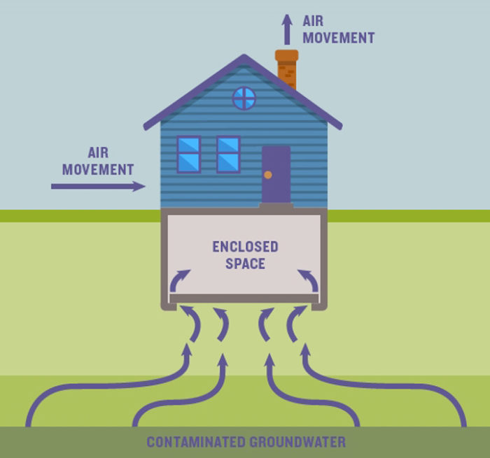

Both radon and man-made vapors can enter a building in much the same way that dirt is drawn into a vacuum cleaner. Suction is created when air moves from areas of high pressure to comparatively low pressure. So just as the suction created at the floor by a vacuum cleaner pulls in small particles and traps them inside a bag or compartment, air movement can draw toxic vapors into a house through cracks or other openings in the foundation.
“It’s basic physics,” says William Suk, director of the Superfund Research Program at the National Institute of Environmental Health Sciences. “Gases have to go somewhere, and they will find a way to go up.”
