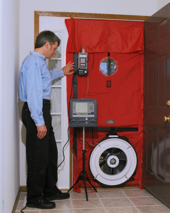

Air leakage is calculated with a blower-door test. A technician depressurizes the house with a blower sealed into a doorway and measures how much air can pass through the building envelope.
The result is typically described either as air changes per hour at a pressure difference of 50 pascals — ach50 in industry lingo — or cubic feet per minute (CFM) @ 50 pascals. Either way, air leakage becomes a known value. If the house is too leaky, the builder can take corrective steps to tighten it up.

    I would heartily endose Peter Yost's suggestion of making your own blower door. The real value of blower door testing is not in getting a value, but rather in using it to find the air leaks and remedy them. We got our home to 0.6 ACH @50 pascals, and practical thing we learned in doing it was that our hands were the most efficient things at finding leaks. We had all the gizmo's like infrared imaging and theater smoke, which were fine for finding overlooked "gushers", but thanks to doing it when it was cold inside, and warm inside, you could pass your hands over the usual suspect places and immediately feel them.
    we used our blower door continuously for 4-5 days, and got my family busy with a "caulk and foam" party over a weekend. It was very helpful to understand first hand, bad pun, how air can enter a house.

    Most days, you can buy a little-used blower door on eBay for a bit over $2000, and you could sell it again for about the same money, paying only the eBay costs that will amount to about 8%, assuming you keep it in excellent condition and the market trend continues (and I think it will, since more and more jurisdictions will be enforcing some sort of testing requirement). With some study, you can run your own tests at whatever stages of construction you choose, without hiring someone to come in every time.
    This isn't a strategy for everyone, but a smart and focused DIY could pull it off.
