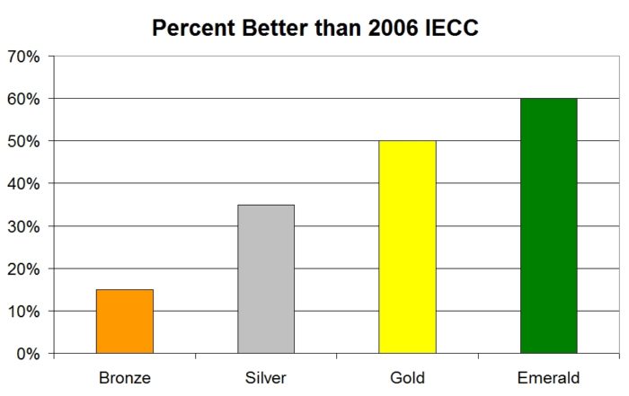

Like LEED for Homes, the residential green building rating system developed by the U.S. Green Building Council (USGBC), ICC-700 has four compliance levels. While LEED for Homes calls its levels certified, silver, gold, and platinum, ICC-700 uses the terms bronze, silver, gold, and emerald.

For bronze certification, a home must be designed to use 15% less energy than a home that minimally complies with the 2006 International Energy Conservation Code (IECC). To reach the emerald level, a home must achieve a 65% reduction in projected energy use. All houses must include a mechanical ventilation system complying with ASHRAE Standard 62.2.
