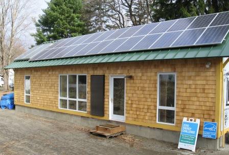

Giving back to the grid This home won the Zero Energy Challenge, a competition among five Massachusetts homebuilders to construct super-efficient market-rate and affordable homes. Completed last year and lived in since December, this house has so far generated a surplus of electrical power.

Bick Corsa Construction took the $25,000 top prize for a 1,152-sq.-ft. three-bedroom home the company completed last year in Montague for about $200,000. Occupied since December by its owners, Tina Stephens and Doug Clarke, the home has so far produced more electricity than it has used.
