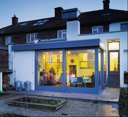

Image Credit: All photos: Construct Ireland Extensive glazing allows abundant natural light into the addition, which Victoria says is “quite energy efficient even though it's north-facing.” A model showing the design of the upgraded house, with the extension configured as a kitchen/family room and utility space Set down near the banks of the River Dodder, the wood-frame studio is sufficiently detached and secluded from the main house, located at the bottom of the garden. A sedum roof further helps it to blend in with its green surroundings. “You don't need to heat it unless it's really cold,” Ryan says the of the addition. Eamon Ryan, standing outside his renovated home, is delighted to see projects like this become more and more common. He believes people are becoming convinced of the merits of retrofitting as they see the “experience other people have in terms of warmer, more comfortable, more attractive houses.” Both the addition and the studio have sedum roofs that soak up rainwater, helping to reduce drainage requirements. Period-look double-glazed windows were installed at the front of the dwelling to preserve the original design of the house. Kingpsan Thermomax solar evacuated tubes provide “piping hot water,” Victoria says, while a solar photovoltaic array contributes to the house's electricity requirements.

But the poroton (fired clay) block addition at the back got triple glazing, and Eamon’s impressed with its performance. “It’s quite energy efficient even though it’s north-facing,” he says of the extension. “You don’t need to heat it unless it’s really cold. So it’s been a real pleasure to see something just work.”

Architecturally, whilst the street façade is extended to match the existing brick and balance the neighbor’s addition, the rear of the house differentiates old and new with rendered masonry, a sedum roof and large triple-glazed openings relating to both the garden and the wider view. The reconfiguration of the house at the rear was to provide a kitchen/family room and utility space.
The ceiling of the addition is insulated with hemp
The internal design of this mediates between the different levels of the site using this step between house and garden to create a fireplace, seating and a log store. The new family room was designed to take advantage of the view to the garden and spatially to open out to it. This created the issue of large areas of glazing to the north and west elevations which we could only justify through the use of triple glazing.
The additions’s walls are 425 mm thick honeycomb terracotta blocks beneath a timber roof insulated with 250 mm of thermo-hemp insulation, giving the extension a feeling of solidity that contrasts with the glazed openings.
