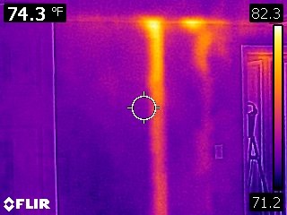

Termal image of attic leak

Performing energy audits and blower door tests in older homes has taught me where to look for air leaks. Often, thermal imaging will find the unsealed electrical and plumbing holes that have been drilled into unconditioned attic and crawlspaces. The thermal image above was taken during the summer when the attic space was hotter than the living space; it shows both an unsealed wire penetration (right) and unsealed plumbing vent (left) that connect the home with unconditioned attic.
During the blower door test hot air was drawn down these holes and into the wall cavity. In the case of the electrical penetration, the air was entering the home through the light switch on an interior wall. The plumbing penetration was an air pathway from the basement to the attic. The blower door created an artificial pressure to allow us to find these leaks.
