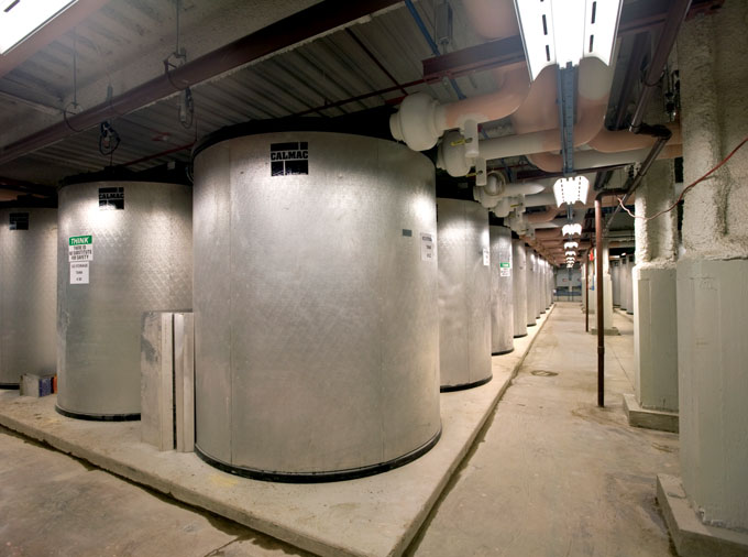

Calmac IceBank tanks at One Bryant Park in New York City, one of the nation's greenest high-rise buildings.

Thousands of TES systems have been installed in commercial buildings throughout North America. I recently toured one in New York City’s newest high rise office building (and the city’s second-tallest building): the Bank of America Building at One Bryant Park, near Times Square. Three floors below ground level are 44 large insulated tanks made by Calmac Manufacturing where ice is produced each night; these satisfy about a quarter of the building’s cooling demand.
