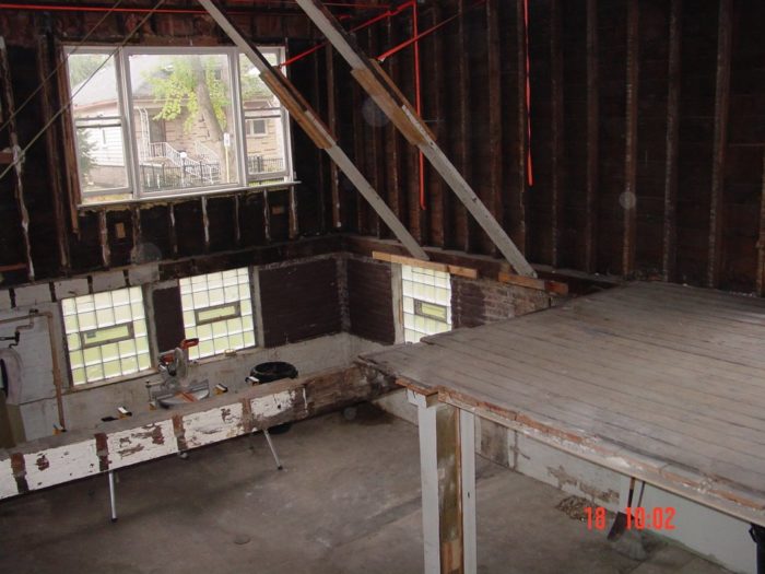

Carpenter Tim Heppner and his brother, Charles, bought a 100-year-old home in South Chicago a few years ago, and eventually decided they could transform it into one of the greenest houses in the city. Tim, formerly based in Iowa City, Iowa, also served as the architect for the project, which now features an airtight shell, reflective metal roof, rain recovery system, and, after deconstructing the interior (as shown here), reuse of the home’s wood materials. Completion is expected in June.
Image Credit: Tim Heppner

The Heppeners’ project, which they expect to complete in June, involved removing the walls and floors, and then reusing much of the removed material (particularly the old-growth framing, hardwood flooring, sub-flooring, and joists) in the home’s reconstruction. The metal, concrete, glass blocks, and windows that were extracted from the house were recycled.
