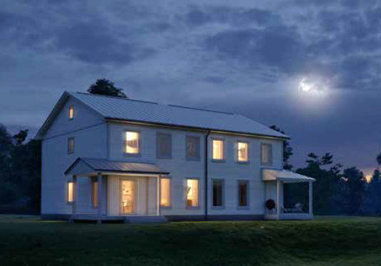

A project called the Ancram Rural Build will be two houses on two separate lots sharing a common wall, what architect Dennis Wedlick calls a zero lot line subdivision. The Passive House duplex shown in this rendering will be nearly identical to several that have been built in an area north of New York City under the auspices of Columbia County Habitat for Humanity. (Illustration: Jeff Brink)
Image Credit: Image #1: Jeff Brink

It took some finagling and a zoning variance to clear the zero lot line building, but work is now underway on the first one in an Ancram hamlet called Ancramdale. BarlisWedlick is donating its time and expertise to the project along with the Levy Partnership and O’Leary Engineering.
An evolving design
As described by BarlisWedlick, the house at Ancramdale (located in Climate Zone 5A) will be built on a concrete slab that’s been insulated with 12 inches of Neopor, a graphite-impregnated expanded polystyrene insulation.
Double-stud walls consist of two 2×4 walls on 24-inch centers. Walls are insulated with 2 inches of closed-cell polyurethane foam and about 10 inches of dense-packed cellulose. The trussed roof will be insulated with 24 inches of loose-fill cellulose.
Windows are Alpen’s 725 series, a triple-glazed unit with two panes of glass and a suspended film between them.
The principal air barrier is Zip sheathing and tape, on both the roof and exterior walls. A polyethylene vapor barrier will be installed beneath the slab. The cladding will be a mix of vinyl siding and vertical shiplap wood siding. BarlisWedlick calculates R-values as 56.8 under the slab, 41.4 in exterior walls, and 81 in the ceiling.
Mechanicals consist of a one-head Mitsubishi ductless minisplit for heating and cooling, an electric water heater, and an energy-recovery ventilator.
