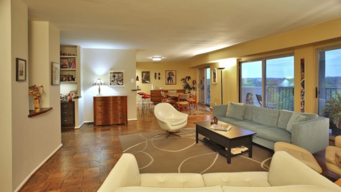

That brings us to our green remodeling story. Our clients found a bleak, worn-out wreck of a place and loved it into a work of lifestyle art.
To see what they walked into, check out Image #2, below. Where others may have flinched and fled, they saw potential. Image #3 shows the same view after renovation: partition walls have moved and been shaped to allow light from the floor-to-ceiling glass doors to reach the back wall of the condo unit.

When the Parkside Plaza building converted to condominiums around 1988, several pairs of one-bedroom apartments on the top floors were combined to create spacious luxury units.
Except …
The apartments had been stuck simply (and oddly) together, the possibilities of the combined spaces left unexplored. As a result, the space lacked definition or any unifying themes. Closets and storage spaces were haphazard. Nothing related to anything else.
And …
The original single-glazed windows and doors leaked, rattled, and whistled in the wind. The heating/cooling units were choked with crud and they leaked, ruining the floors.
And, finally …
The kitchen. It was one of those kitchens made so long before we learned how to “do” kitchens that it doesn’t seem fair to criticize. Boxed off from the main living area, it cried out to be set free of confining partitions. It is enough to say it was intolerable to our empty-nesters.

Was there anything good about the place? Yes! It was luxuriously spacious. Truly splendid, however, were the floor-to-ceiling sliding glass doors framing a wall of sky beyond twin over-sized balconies. This! This was worth the work. And work there was.
Even with so much wrong, the renovation relied more on the scalpel than the wrecking ball. As shown in the detail below (see Image #5), partitions and doorways were reshaped and finessed.
The redesign would focus on defining functional spaces for work, hobbies, and overnight guests. It would bring order and reason to bear upon unreasonably bad feng shui.
Making sense of space: interior realignment
Transitions were clarified. Storage was optimized. What had been a dark and creepy passageway to the second bedroom was illuminated by interior windows and divided-light bedroom doors.
The kitchen was fully integrated into the adjacent living areas (see Image #8, below).

Materials were selected with sustainability in mind. These included wood counters and shelves crafted from urban harvest walnut and cherry (see Image #9).
Patrick Sells of Salvaging Creativity, York, Pennsylvania, fabricated the range hood with stainless steel from a local scrapyard (see Image #10). It was a thrill to be able to work with these artists to incorporate reused and recycled materials in the project.
To ensure healthful indoor air quality, cabinets were made with zero-formaldehyde materials and finished with no-VOC coatings.
One of the huge successes in this green living project is the use of color (see Image #12, below, showing the master bedroom). The owner, an artist in her own right, created the palette.

Sustainable design elements included in this green remodeling project feature the usual cast of characters: LED lighting, Water Sense fixtures, Energy Star appliances, and energy-saving doors and windows insulated with low-e, argon-filled double glazing.
But the most sustainable aspect of this green living project is downsizing. It proves that it is possible to do much more with much less than we think we may need.
