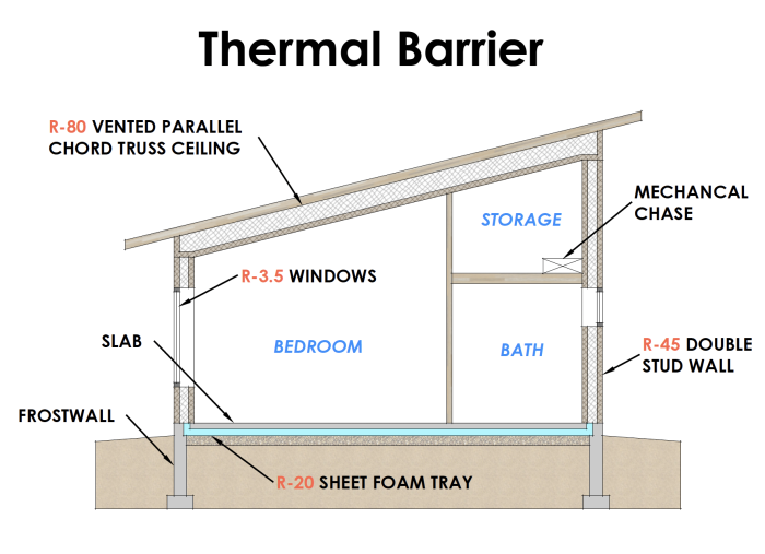

Thermal Barrier
Knowing the IRC’s prescriptive R-values enables the dialing in of building assemblies and insulation material options.
More insulation, better windows, and an above-code blower door number directly impact operational costs, which are broken down by component in REM/Design’s Action Report. You may find that the foundation walls lose more heat than the ceiling does. If the material and labor cost to upgrade the foundation wall insulation is equivalent to adding more insulation at the ceiling, then this is what you should consider doing. Worried that a large window faces north toward the view and not south like it “should”? Face your guilt head-on and model the difference: it’s probably not as big as you think.

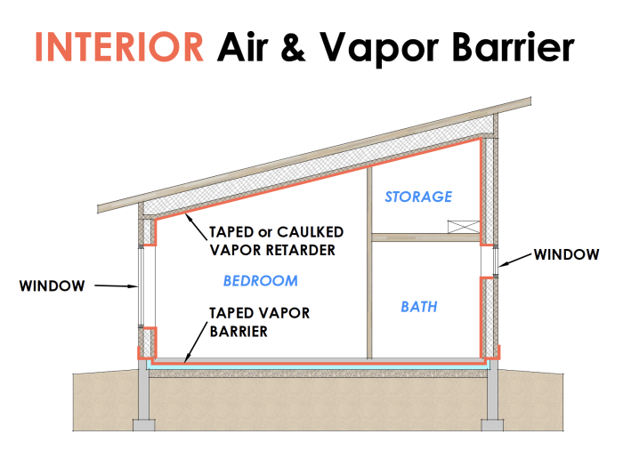

Interior Air and Vapor Barrier
An effective air barrier strategy and installation can go a good way of the distance toward getting to net–zero energy use. Air-sealing is the low-hanging fruit and a good place to economize on labor.

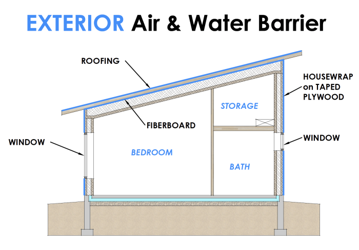

Exterior Air Barrier
I installed Marvin windows and considered an upgrade from their standard dual-pane option to their triple-pane glazing. REM/Design showed me that the upgrade would save me $48/year in heat costs. The quote from the window supplier was an upcharge of $2785. That’s not a lot of money when you’re building a new house, but the simple math isn’t compelling. It would take 58 years for the triple-pane windows to pay for themselves.

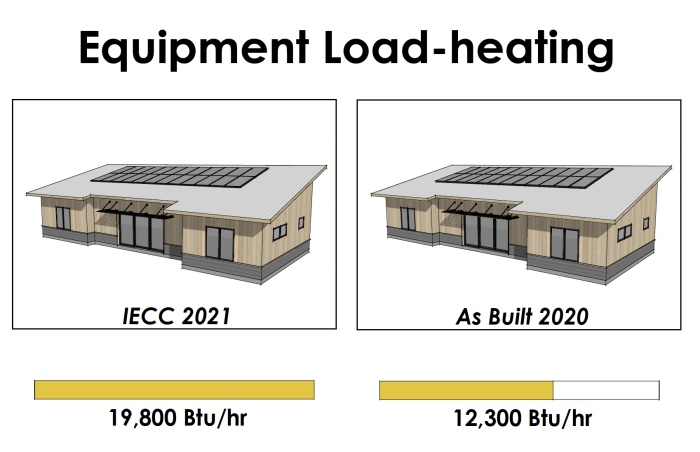

Heating Load
Your REM/Design model will give you a kBtu/hr design load (also known as a peak load) in the Equipment Sizing Report, which you can then match to a potential HVAC selection. Ideally, you can get pricing and compare your code-minimum house with your super-insulated house. If your home is small and the rooms are open to each other like mine, a single ductless air-source heat pump will probably be all you need. Wouldn’t it be cool if the difference in price could pay for your extra insulation and better-than-code windows?
The software’s Equipment Sizing Report meets permitting requirements in my jurisdiction. However, the program can’t produce a room-by-room heat loss calculation, which is essential if you want to condition two or more zones with ductwork or separate equipment.
It’s fun to iterate and get your numbers way down, but keep in mind that what you’re looking for is the sweet spot where cost and value are optimized. You want a comfortable, durable home with low operating costs for a reasonable initial investment and carbon debt (carbon footprint). There’s a point where more insulation or better windows is less effective than more solar PV panels paired with a larger HVAC system.

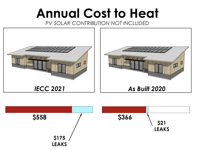

Annual Heating Cost
My final blower door test far exceeded my goal: 0.38 ACH50Pa or 0.02 CFM50/sf. REM/Design estimates that this infiltration rate costs me $21 each heating season. What if I had done a sloppy job of taping and caulking and just met the 2021 IECC requirement of 3.00 ACH50Pa? The infiltration would cost me $175/heating season, about the same as the heat loss attributed to my windows.
Air-sealing is the low-hanging fruit. I can save $154/heating season just for doing a good job with my air barrier work I should do anyway if I care about the indoor air
quality and long-term durability of my house. Tape and caulk are cheap. Upgrading windows is expensive. Here’s my advice: Do all the air-sealing yourself. Don’t expect your contractor or subs to fully appreciate how important it is to you. You will need the correct materials and a practiced technique, but it’s well within your ability.

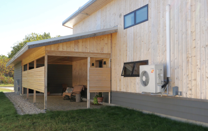

If you want to understand heat pumps and make some preliminary selections, the Cold Climate Air Source Heat Pump Product List and Specifications from Northeast Energy Efficiency Partnerships (NEEP) is an excellent resource. It can’t take the place of working closely with a qualified HVAC contractor, but it does help narrow the field. The online tutorial explains how to use the calculator and interpret the results.
Exterior-wall-mounted heat pump condenser
Even this straightforward ductless heat pump system is oversized for the robust building envelope.
As it turns out, the air source heat pump (ASHP) I selected when planning my house is oversized. The specs aren’t bad, but I could have gone two sizes down and saved money. The equipment could be smaller and run more efficiently. The wild card for me was the blower door test. If I had met the 2021 IECC requirement of 3.00 ACH50Pa, the heat pump I installed would be just right.
