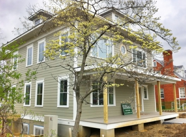

Image Credit: Peabody Architects and O’Neill Construction Structural insulated panels where used for the exterior walls and roof. After they were in place, the construction crew taped the interior corners (before installing timber for the drywall) but not all joints and seams. The construction team wanted to conduct a preliminary blower-door test to verify how effectively the SIPs seal by themselves. After the taping was completed, a second blower-door test was conducted to determine the percentage of added benefit. The joints for this hip dormer were filled with expanding foam that was later rasped smooth. The joints were then covered with SIP tape. The perimeters of all windows and doors were dressed with a layer of high-density extruded polystyrene foam as well as lumber. The building’s “outsulation” consisted of two layers of EPS foam whose staggered sheets were screwed in place. House wrap and vertical strips for the siding were installed over the foam sheets. Looking toward the front the house from its dining area.

The project is now in the finish-work stage and has been put through a couple of preliminary blower-door tests to track down air leaks and affirm that the house is sufficiently airtight. The first test showed about 0.67 air changes per hour at 50 Pascal pressure difference. The second test, conducted before drywall and trim were installed, showed 0.59 ACH, which meets the Passivhaus airtightness requirement.

The home’s exterior walls are built with 8-in. InsulSpan SIPs covered on the exterior with two staggered layers of expanded polystyrene (1 3/4-in. thickness total), bringing the total thermal resistance of the wall assembly to R-36. The foam sheets were covered with Tyvek housewrap and vertical furring strips to create a rainscreen; the siding is HardiePlank fiber cement.
The roof was constructed with 12-in. SIPs, with standard asphalt shingles over felt, for R-45 thermal resistance. Foundation walls are insulated to R-44 with 4 in. of EPS on the exterior and 5.5 in. of fiberglass on the interior, while the concrete slab, at R-20, has 4 in. of EPS with a vapor barrier underneath.
Windows on this project are Thermotech triple-glazed units with insulated sashes and frames, and motorized awnings have been installed on the west wall of the home. (There are roof and porch overhangs on the south wall.)

The exterior insulation was EPS not XPS. The staggered sheets were a standard 1pcf density while the layer behind the window wrap was a 2pcf density.
The blower door numbers were personally very disappointing. However, when you look at the fact that three of the Thermotech units were missing glazing (plywood insert waiting on delivery), and the ill-fitting doors (light can be seen coming through the door seals) I'll have to wait patiently for the final test.
