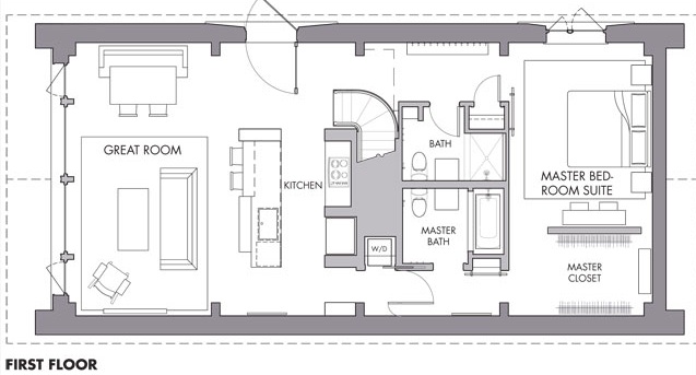

Hudson Passive House, in New York’s Columbia County, though only recently completed, is already familiar to Passive House fans in the region.
Last month, for example, the 1,650-sq.-ft. timber-frame home played host to 20-plus members of New York Passive House (NYPH), a New York City-based group of “Passivists” (consultants, contractors, architects, engineers, homeowners, developers, and others) who caravanned two hours north of the city to the project site in Claverack, a scenic town a few miles east of the Hudson River. Joined by several people from the community, the NYPH contingent participated in what the project’s architect, Dennis Wedlick, and other project partners called the Hudson Passive House Hard-Hat Tour, a show-and-tell event held November 13 and 14.
The three-bedroom, two-bath house also has been the subject of an American Institute of Architects/NYPH presentation, a segment on WABC-TV’s Sunday-morning feature program “New York Viewpoint,” and write-ups in print and online publications, including a recent EcoHome post that brought it to our attention.
A well-sealed envelope
So as new as it is to the landscape, the barn-like Hudson Passive House, whose 25-ft. bow-arch beams were raised in late June, has been successfully marketed into modest celebrity. Structural insulated panels were used for the walls and roof, bringing their respective R values to 48 and 54. The foundation floor is insulated to R-60 with six layers of expanded polystyrene and, on the interior and exterior of the foundation walls, extruded polystyrene.
Mechanical ventilation is provided by a Zehnder ComfoAir 200 heat-recovery ventilator, while space heating is provided by a minisplit air-source heat pump that is mounted in the wall of the loft space at the north end of the building.
The building is exceptionally airtight, even by Passive House standards. A blower-door test showed 0.149 air changes per hour at a pressure difference of 50 Pascals. Wedlick told EcoHome that construction costs likely will range from $200 to $250 per sq. ft. ($330,000 to $412,000).

Exterior Shading
I would expect that the fully glazed south wall would require exterior shading in addition to the overhang to avoid overheating. Can anyone comment on this aspect? Also I'd be interested to know what windows were used.
Thanks
Response to J Chesnut
J,
It looks like the house has windows from Serious Energy:
http://blog.seriousmaterials.com/?p=1298
That might explain the south facade -- most of the low-U-factor windows from Serious are also low-SHGC.

Glazing
Thanks for the responses. This is the glazing spec from their PH factsheet:
I can't find the terminology "g-Wert" in my PHPP manual but I am assuming this is the SHGC number.
51% is pretty high.
g-wert
J,
g-wert (gesamtenergiedurchlassgrad) is the german equivalent of SHGC.
J,
Remember that the g-Wert will be a glazing-only number, not a whole-window number.
The Serious Materials spec sheet for their 725 window series shows that their 725 casement windows can be ordered with two glazing options. One has a SHGC of 0.21, and the other has a SHGC of 0.39.

I don't think the shape of this house lends itself to 4 season solar management.
PHPP
Whether the windows "work" or the solar is "managed" is all determined in the PHPP, the computer modeling tool developed by the Passive House Institute - and an essential element in producing a successful Passive House project. If the specs work out in the PHPP modeling, AND the building is actually constructed accordingly, then the chances of the windows "working" and the solar being "managed" in the 4 seasons is very high indeed.
Intuitively large south facing glass with some overhang and almost no east/west glass, sounds like a very logical place to start. With the rest of the PH methodology of continuous insulation, elimination of thermal bridging, air-tightness and continuous low volume ventilation with high efficiency heat recovery - it seems like it should be "easy" to achieve great interior comfort and the deep energy savings that characterizes Passive House.

summertime overheating
PHPP has a tag that shows whether your building is overheating in summer, and various methods to mitigate the overheating, including shading outside the thermal envelope, night ventilation, etc.
also to note, contrary to standard thinking, you can achieve PH with a sizeable portion of north glazing.
