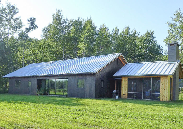

![](http://images.greenbuildingadvisor.com/app/uploads/2018/07/24192256/Front%20of%20house-main-700x492.jpg)
Image Credit: Elden Lindamood

And it’s nice place to come home to (see Image #8).
