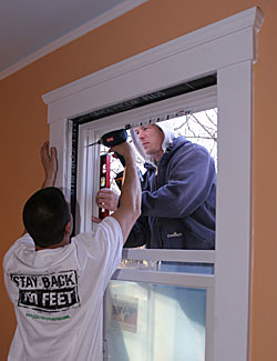

With the bottom and top of the house sealed and insulated, as well as the walls, windows represent the next opportunity. Old windows often leak both air and water into the house. They might not open and close properly, and are sometimes be obscured by unattractive storm windows and screens that reduce the amount of light that can enter. Moreover, they rarely have low-e glazing.
Properly installed Energy Star (or better) windows seal the holes in the walls to keep out water and weather extremes. If high-quality glazing is specified, the windows can admit useful solar gain during the winter, while still preventing excessive heat loss at night. To prevent summer overheating, the best glazing for east and west windows is usually low-solar-gain glazing.
Properly specified new replacement windows should reduce your energy bills. Since replacement windows are expensive, though, don’t expect a fast payback on your investment. But if you decide to replace your windows, at least you can enjoy higher comfort from Day One.
