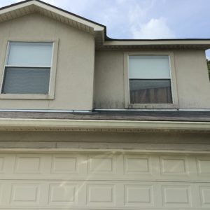

How should stucco be installed to avoid the wall-rot problems plaguing thousands of U.S. houses?
Rotten OSB. All of the stucco was removed from this 10-year-old Minnesota home to determine how much of the OSB sheathing had turned to oatmeal.
Image Credit: Images #1 and #2: Energy Design Update
In many areas of the country, hundreds of stucco-clad homes have suffered wall rot. Although building scientists are still researching the causes of wall rot behind stucco, it’s clear that all of these walls got wet and were unable to dry.
Among the reasons that have been proposed for the recent epidemic of stucco-clad homes with wall rot:
  • Many of the houses had OSB sheathing, which is more susceptible to rot than plywood or board sheathing.
  • Many of the houses had only one layer of Grade D paper or asphalt felt under the stucco rather than two.
  • The homes lacked a ventilated air gap between the stucco and the sheathing.
  • In many of the homes, interior polyethylene prevented the walls from drying to the interior.
  • Many of the homes had flashing errors.
  • Some of the homes had high indoor humidity coupled with an imperfect air barrier.

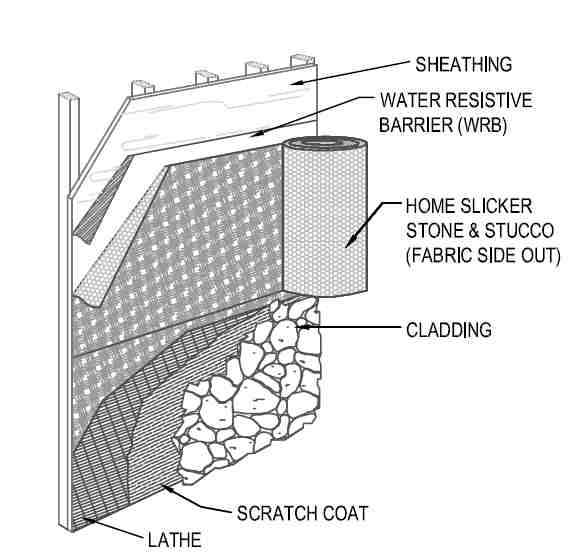

    You can definitely install stucco on top of furring strips. In my article, I suggested the technique:
    "If you’re installing stucco over foam, here’s how to create a ventilated rainscreen gap:
    * Install 1x3 or 1x4 vertical strapping on top of the foam, screwed through the foam into the studs.
    * Fasten paper-backed metal lath to the strapping, and proceed with a standard installation of three-coat stucco."
    For many decades in California, stucco was installed directly over the studs, without any sheathing whatsoever. Asphalt felt, then metal lath, then stucco -- that was all.
    These days, it makes more sense to start with wall sheathing: rigid foam, diagonal boards, or plywood. Then feel free to install vertical strapping and stucco.

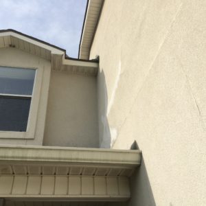

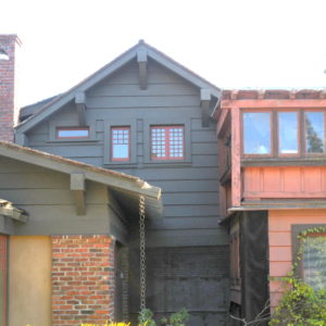

    1. user-7941404 | | #70
      Hi Martin, I've been reading up and trying to learn as much as I can about building the best possible building envelope (searching articles here, reading Pretty Good House, etc.), but most of the information is focused on colder climates than here in Southern California. We're renovating a house in Los Angeles built in 1938, and I'm convinced the only reason its still standing is because it was so leaky (had/has just about every issue you can think of when it comes to waterproofing and drainage).. It has standard 2x4 walls and we plan to recess the windows (do an "innie" installation) with a stucco finish so I've been asking installers about continuous exterior insulation and they just look at me with a blank face. I'm sure there's a lot of carryover but I am having a tough time figuring out whats overkill and what might actually cause problems in our climate. Do any articles or books come to mind that focus more on best practices here in CA? Thanks for your help,
      Curtis
      1. MartinHolladay | | #71
        Curtis,
        California is a big state, with a great many climates, so it's hard to generalize. In your area (Los Angeles), energy bills for heating and cooling are relatively low, so it's no surprise to learn that few builders bother with continuous exterior insulation. The reductions in energy use attributable to such insulation are too low to justify the investment.
        Perhaps some GBA readers will suggest the names of books or articles that are relevant to your climate.

  45. joelyfree | | #45
    stucco and airgap question
    Thanks for the article. I have a question I cant seem to find the answer too.I am remodeling my house down to the studs. Put In cellulose insulation and OSB. Going with stucco on bottom half. I forked out the bucks and bought Homeslicker stone and stuccoto to create a 1/4 inch air gap. We have installed standard tyvek on the OSB and have the home slicker stone and stucco over it. So my big question is do we need another layer of felt down on the outside of the homeslicker or is the layer of stucco blocking fabric that comes with the product good enough ?
    To be more explicit. Code requires two layers of felt due to the fact that stucco binds to the first layer leaving the second an intact weather barrier. Is this kind of protection needed with homeslicker stone and stucco product? Would adding a layer of felt on the outside of the homeslicker air gap creat some kind of unintended consequences?
  46. GBA Editor
    Martin Holladay | | #46
    Response to Joel Kauffman
    Joel,
    There are really three questions here:
    1. What does the manufacturer of Home Slicker Stone and Stucco require?
    2. What will your local building inspector require?
    3. How much risk are you willing to accept?
    For the answer to question 1, see this document: Home Slicker Stone and Stucco Installation Instructions. That document recommends that lath and stucco can be installed on top of the product in question, as long as there is a WRB between the wall sheathing and the Home Slicker. (See illustration below.)
    For the answer to question 2, contact your local building department. Your inspector may want to see an additional layer of building paper or asphalt felt on the exterior side of the Home Slicker Stone and Stucco, because the wording of the building code gives your inspector that latitude.
    The answer to question 3 is hard to pin down. However, after researching stucco failures, which are very common, I would include a layer of asphalt felt (or use paper-backed lath) on the exterior side of the Home Slicker product if I were building a home with stucco. Asphalt felt is cheap, and the insurance is worth it.

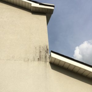

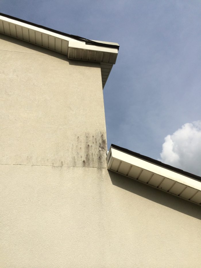

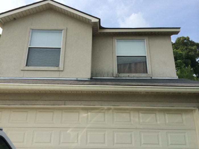

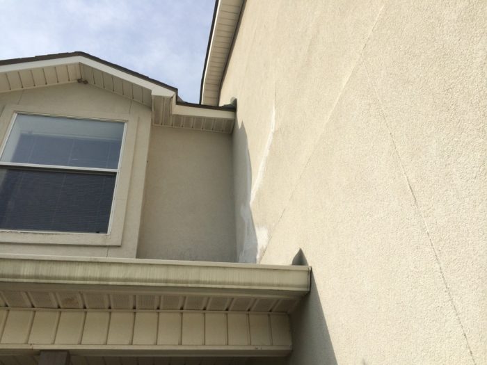

  50. A.Jo. | | #50
    stucco failure images - bulging of stucco walls
    Great post, thank you! Is it common or possible that a stucco wall that is bluging by about 2 inches(and cracking) is caused by an improperly secured metal lathe or would you suspect wet OSB to bulge that much?
    [Editor's note: The read an answer to this question, and to read other comments, advance to Page 2 by clicking on the "2" below. ]
    https://isthisgoodorwhat.files.wordpress.com/2015/07/location1.jpg
    https://isthisgoodorwhat.files.wordpress.com/2015/07/location2.jpg
    https://isthisgoodorwhat.files.wordpress.com/2015/07/location3.jpg
  51. GBA Editor
    Martin Holladay | | #51
    Response to Adrian Jo
    Adrian,
    It's impossible to determine what's going on without a site visit. I can make some guesses, but they are just guesses.
    In any case, if you have stucco that is bulging out 2 inches and cracking, someone is going to need to remove a section of stucco to investigate and repair the problem. Once the damaged area of stucco is removed, you will be able to see what's going on.
    Here are my guesses:
    1. In Photo #1, ineffective kickout flashing on the roof above the problem area is somehow allowing water to enter the wall. If my guess is correct, the solution will involve flashing corrections.
    2. In Photo #2, the mold on the wall is due to spashback from the nearby roof. The splashback occurs when water from the higher roof dumps water onto the lower roof. There may be nothing wrong with the stucco here.
    3. In Photo #3, the mold on the stucco and damage to the window casing is due to splashback from the nearby roof. Again, the splashback occurs when water from the higher roof dumps water onto the lower roof. One possible solution to this problem (and the problem shown in Photo #2) is to install a gutter on the higher roof.
    One other thing I noticed: the soffit vents are all dark. This probably indicates that you live in a dusty area, or an area with polluted air.
