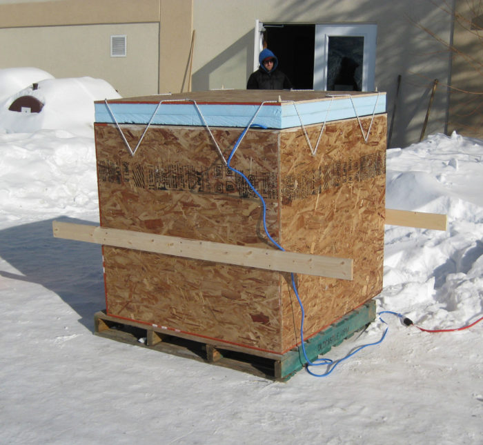

Putting “insulating” paint to the test. To measure the effectiveness of Nansulate and Super Therm — two paints that are touted for their “insulating” properties — researchers built 3-foot-high test boxes with 2x4 frames and OSB sheathing. The walls of the boxes were insulated with fiberglass batts, while the lids were insulated with 4 in. of extruded polystyrene. The interior walls and ceilings of the boxes were finished with painted drywall. [Image Credit: Cold Climate Housing Research Center]
